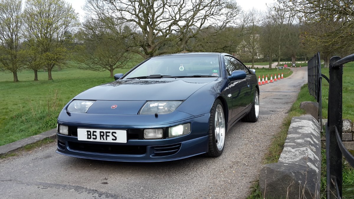

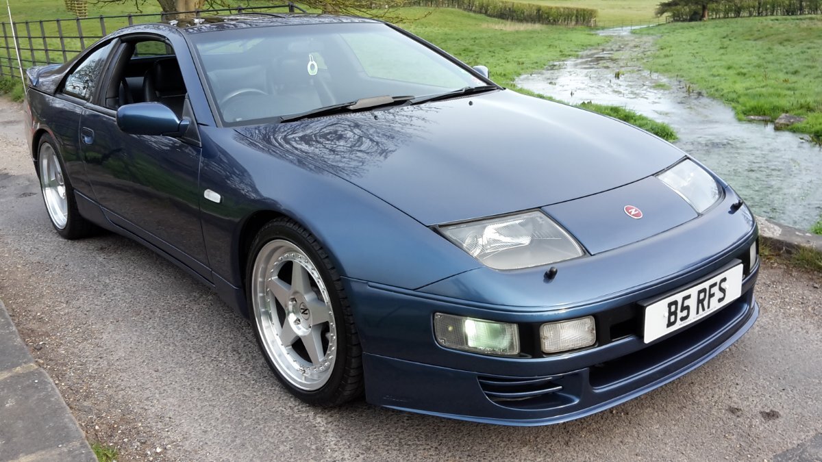

Having a UK-spec Zed, I replaced my blank corner units with a modified set (thanks Andy ? ) in which I installed some powerful LEDs......
...Any excuse to post some Zed pics ?
