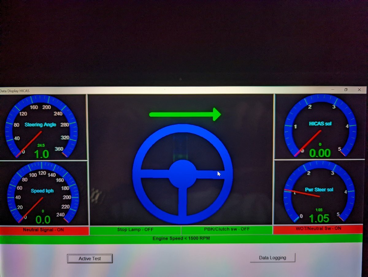

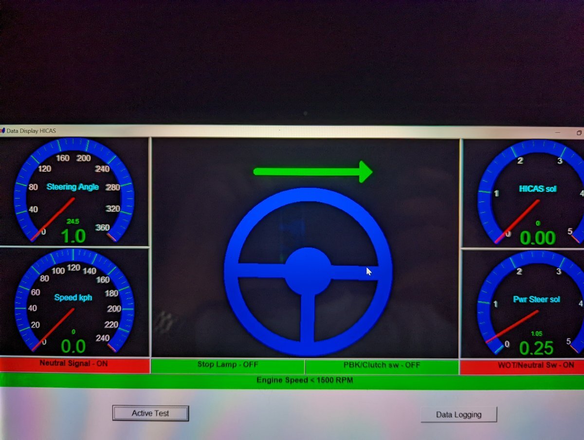

Ok so I purchased Datascan to get more info on the sensors and power steering related items. All the relevant sensors are reporting in okay and seem to be functional. I had a question around the power steering solenoid though. My outputs are below:
Engine Off:
Engine On:
I don't really know what the metric is for the power steering solenoid value. I was wondering if anyone knew whether 1.05 for engine off and falling to 0.25 at engine on and stationery is normal?
