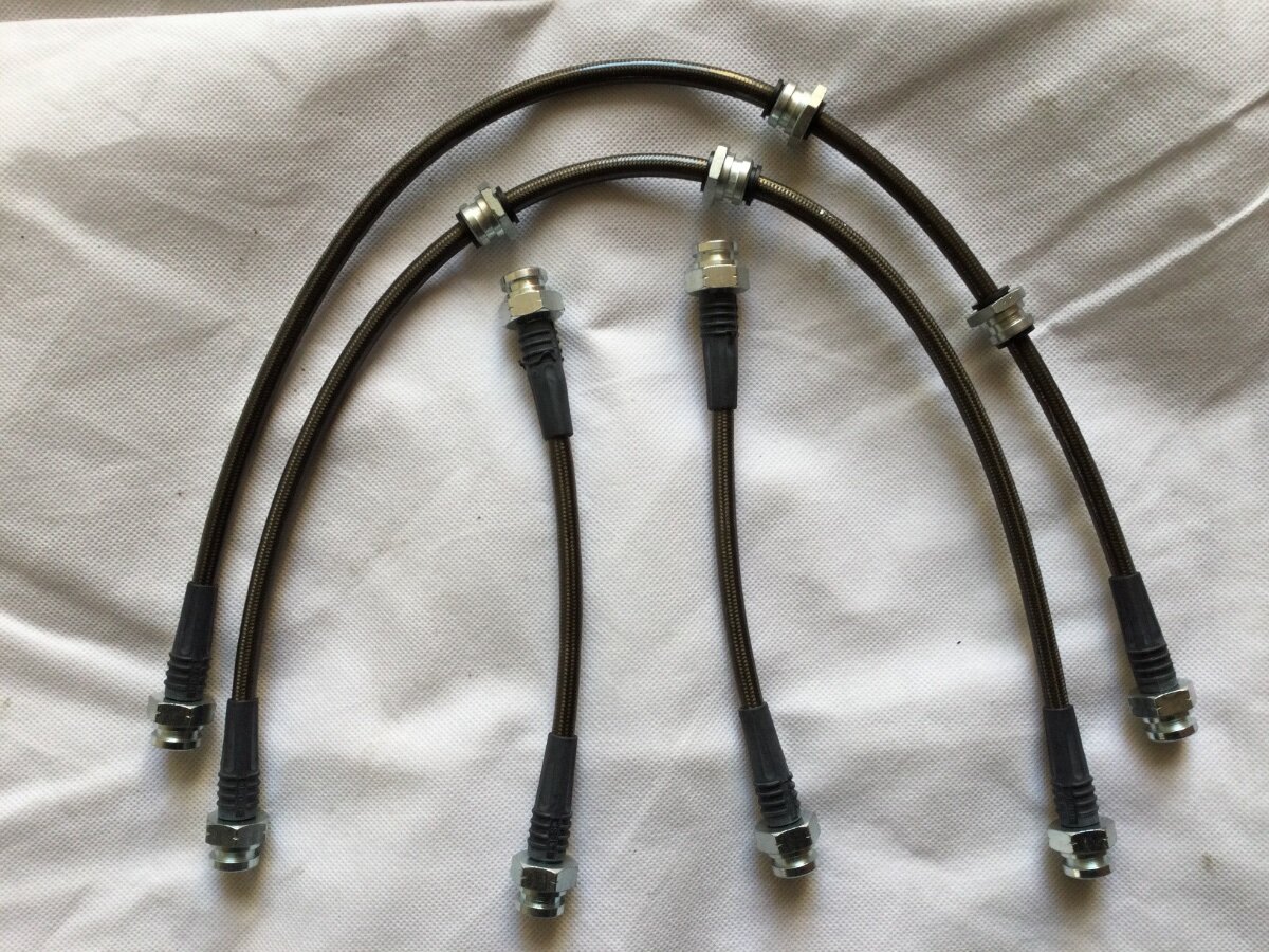

hi guys as I need to get brake pipes replaced in the coming weeks, I've decided I need to also replace the rubber Flexi hoses as these are starting to go hard, I think they are the originals. are these braided hoses the correct ones? I see 2 different types listed for the zed, but I'm not sure if there are the right ones

Got a link to the ones you have posted?
If you are running stock (or R33 brembo) calipers and keeping the short hardlines (see link below for example) from the calipers then yes.
https://conceptzperformance.com/nissan-infiniti-nissan-oem-300zx-front-brake-caliper-fluid-line-tube-rh-z32-46245-33p10_p_6045.php
Here are the Technafit I've used in the past:
https://conceptzperformance.com/technafit-teflon-coated-stainless-steel-brake-lines-nissan-300zx-z32-nis-1300_p_1886.php
hi Andrew these are the ones, what made me stop and look was it says 'minor mods' maybe needed, but I'm running stock callipers (early JDM series 1)

as for the ebay ones I ordered a set, they arrived today and they only have one strain relief mounting not 2 as required, which would leave the hose rubbing against a metal edge so they are now going back.
