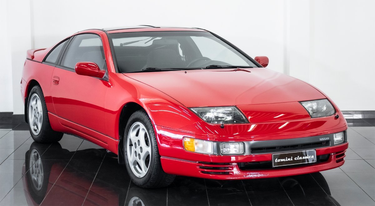

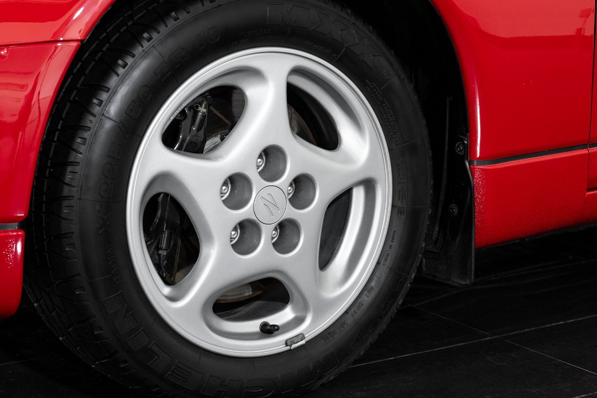

Came across this lovely example (now sold) at Tomini Classics in Dubai. What caught my eye apart from the superb
condition of this car was the big brake kit fitted under the stock front wheels. I've seen cars with the stock calipers
moved out with larger disks under stock wheels but this looks to be a BBK with much larger calipers and two piece
brake discs. Very nicely done. Right click on images in link for nice hires.

This is what I want mine to look like. Andrew please tell me more about the brakes. I wish to have bigger/better brakes on my car but retain the stock wheels....
CZP do a Stoptech kit specifically engineered to go under the standard wheels. Relatively cheap for a new BBK too.
Just now, AndrewG said:
That kit uses stock sized 280mm disks though.
...perhaps I should have said BK, not BBK. Ha. Thought it fit the bill for the "better" part of the question though.
I don't (as yet) have anything further on the brakes fitted in the Dubai car Tom but this info may be of use to you.
R32 GTR disks are 296mm as opposed to the Z32 stock 280mm, so slightly larger (and thicker) The R32 calipers and discs will
fit under stock wheels with a thin spacers.
