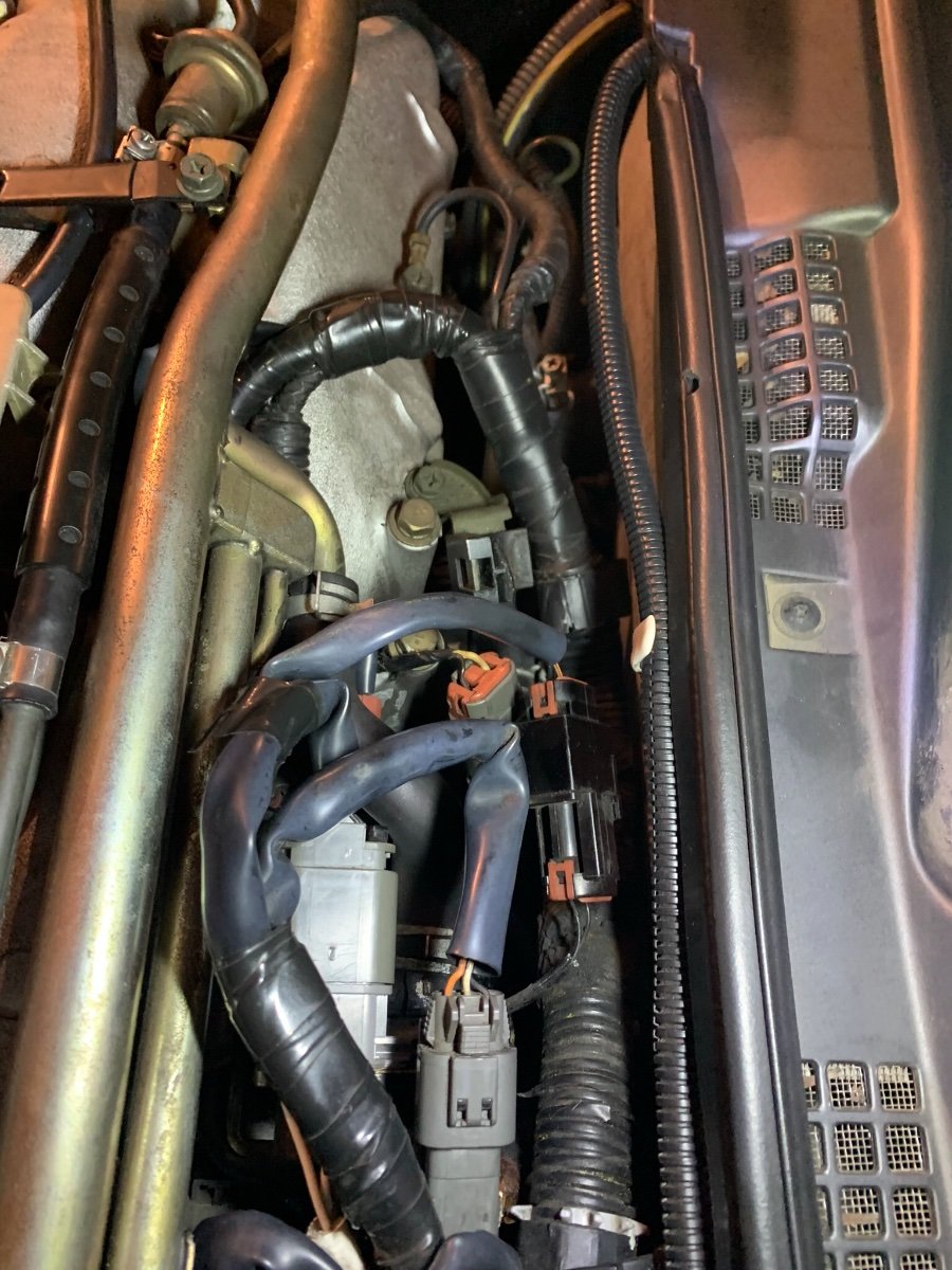

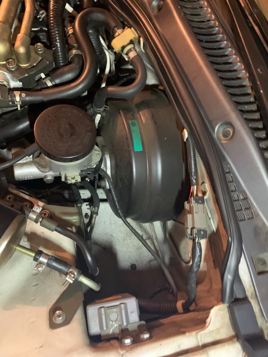

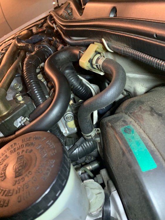

I am posting some pics and could use some help identifying what is what.

I would work back through what you disconnected checking connections and looms. Reconnect everything, check for broken plugs and green electrical gunk. Have you run the engine codes yet?
