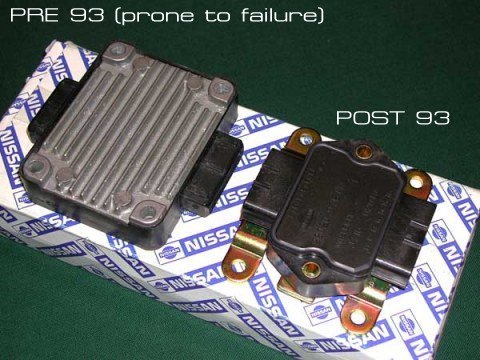

If you have an early PTU fitted (left in picture) then they are prone to failure from heat and vibration. The symptoms being missing
and/or complete failure after getting hot.  Nissan produced a replacement PTU (right in picture) which fixes the problem. It is also worth
upgrading anyway to the later PTU as a preventative measure. Also check the PTU connectors for corrosion and clean if needed.
ptu.jpg.2e0bde73529578ab338d494b12fb43c6.jpga
The replacement kit is available from here (example supplier) and is plug and play replacement:
