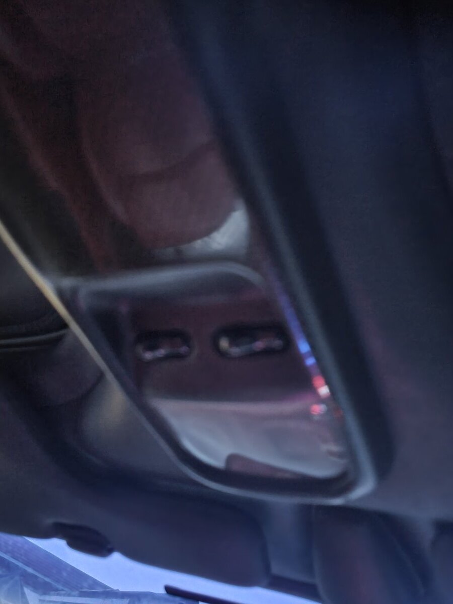

Buzzing sound from overhead console
Thought it was the speakers in the Z but finally traced it to the overhead console with the 2 interior light buttons
Is this a type of fan / ventilation system that is making the noise?
