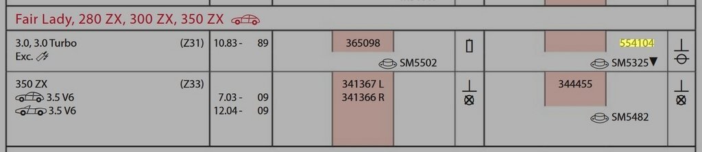

Dear knowledgeable ones, I need to replace my rear suspension and bought, what I thought was correct for the car, going by the registration number (Suspension part was KYB554104 KYB1). The garage told me that because the car was an import, the suspension  I bought would not fit: it appears that imported ZX’s have different fittings from the British bought cars. I find this strange but it appears to be true. Can anyone offer advice, especially if you have had the same problem with an import? Perhaps there is a specialist I can go to.
The KYB catalog lists the 554104 for the Z31 300ZX (page 205)
