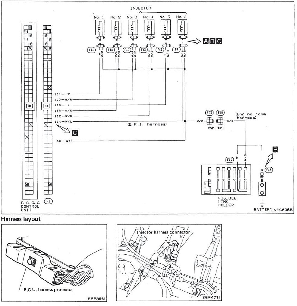

You've checked the injector resistance (good is between 10 and 14Ω), the connector and wiring for No 2? The W/R (white/green) wire from ECU pin 110 has
continuity to No 2 signal pin? +12v is present on the other pin? Check that the ECU connector is seated correctly.
Assuming that +12v is getting to the connector, you can see if the ECU itself is sending a signal to No 2 by putting a 12V LED across the unplugged injector connector
and starting the engine.  See if the LED flashes. This will help confirm a no signal situation to the injector (if you don't see the LED flash, try swapping the LED around in
case the LED's +12v and GND needs to be reversed).

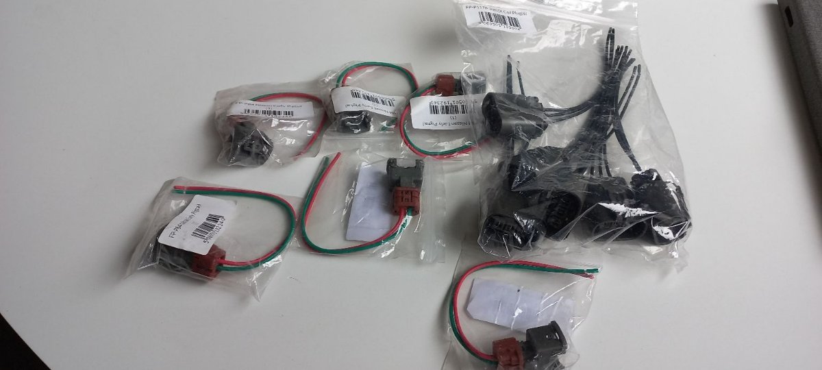

I concur with Andrew - before condemning the injector, have you checked the connectors?
I had a similar issue and it wasn't the injector, the pins on the connector plugs had become corroded. Jimmer cleaned them a couple of times - which cured the problem for a while - but in the end, I went for a replacement set of connectors.

Running on 5 yesterday but fiddled with connectors and back on 6 again. But going to get new coil pack connectors and can you get new injector connectors?
