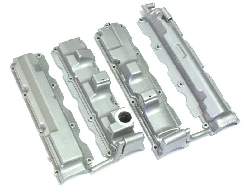

Here is the cam covers
You can see the pipes on each one that connect to the pipes you circled.
As your covers are removed that's likely why the confusion of where they go.
Cheers I know the cam covers go too the green circled image but was just lost on the metal pipe on where it goes but I belive it goes too the iacv on back of plenum apparently?
