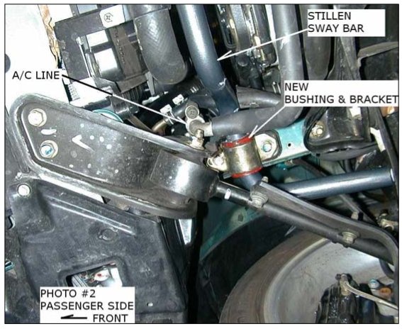

If you are using an aftermarket alloy radiator - the lower coolant hose runs parallel to the front anti roll bar across
the radiator (Stillen and Koyo in my case). I losely clipped a cable tie around them both at the mid point. Picture shows
part of the run.

Thanks all, will cable tie it as planning to swap for an alu radiator at some point
