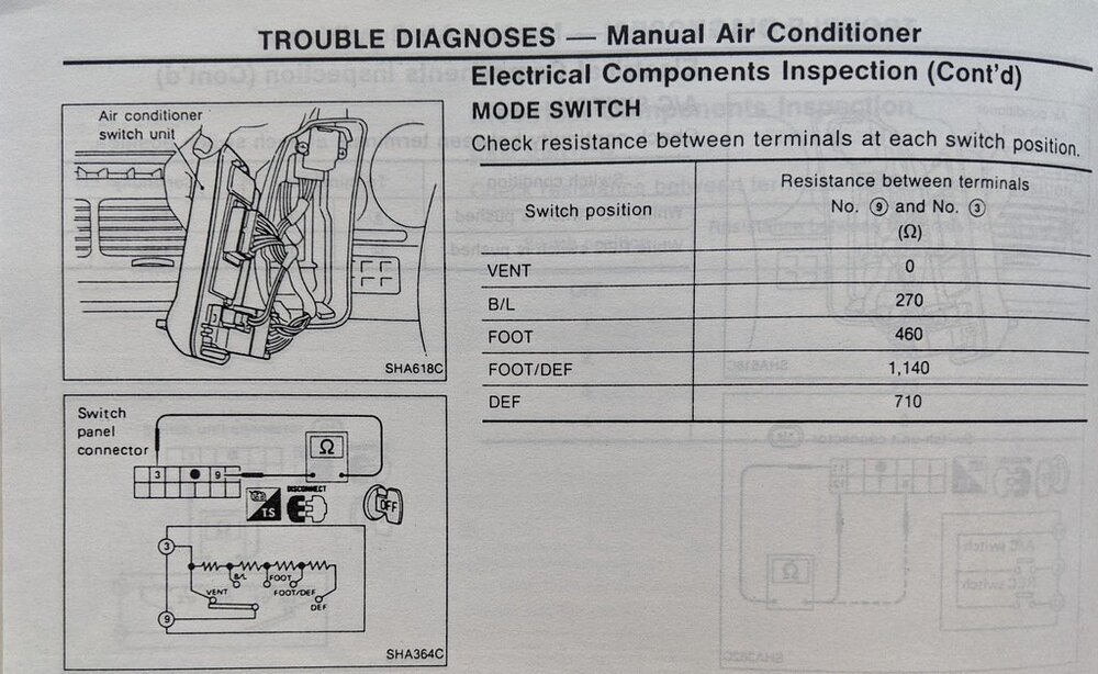

Well from what I can tell the switch seems to be behaving as expected from the circuit diagram (although it’s had to be sure given none of the resistors are labelled with values!). But two things strike me as a little odd:

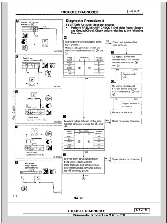

AndrewG you, sir, are a gentleman and a scholar. Those values match what I’m getting.
As it happens I have just found this online (should be a photo attached!)
It passes step A with flying colours, so the switch unit appears to be ok. Which means the problem is probably with the wiring between the switch connector and the amp connector. Deep joy. Looks like I have some ferreting around behind the dash in my immediate future…

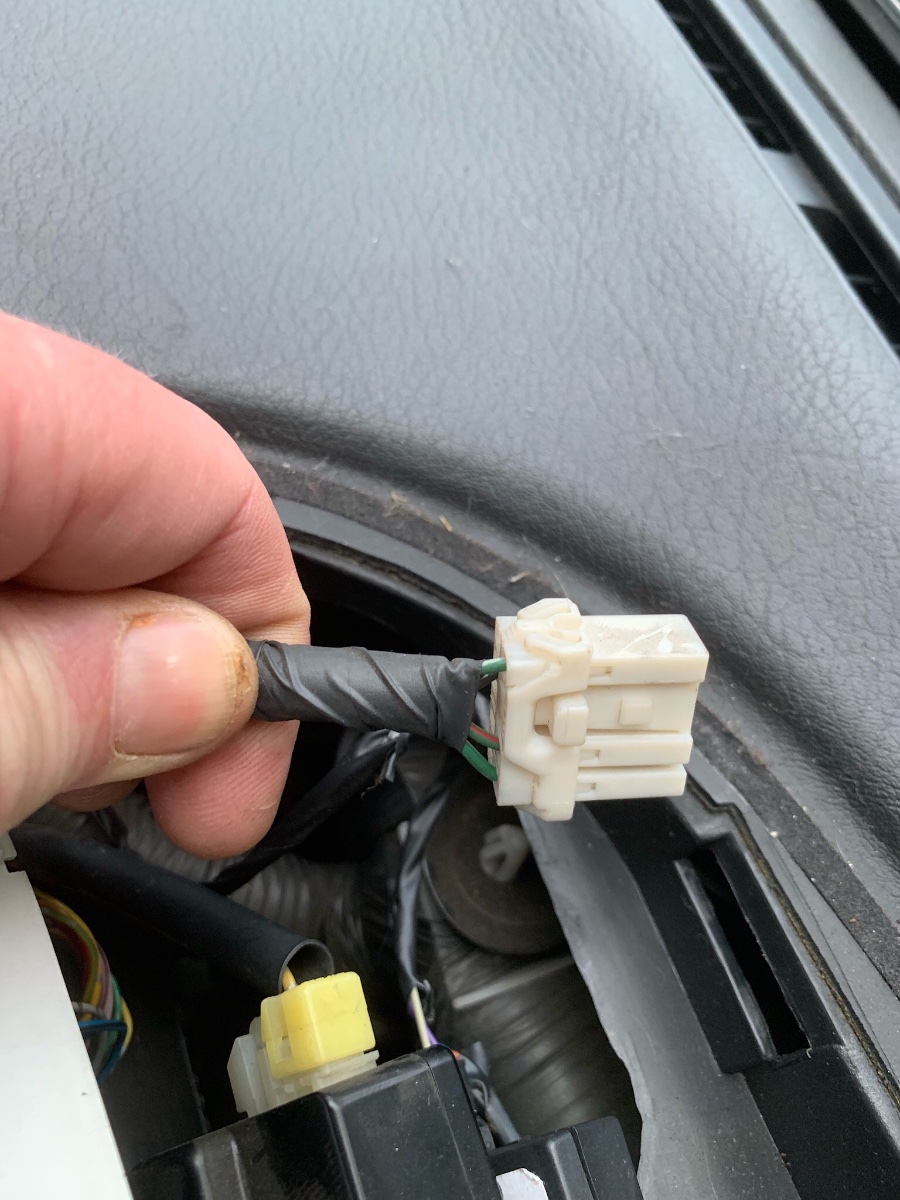

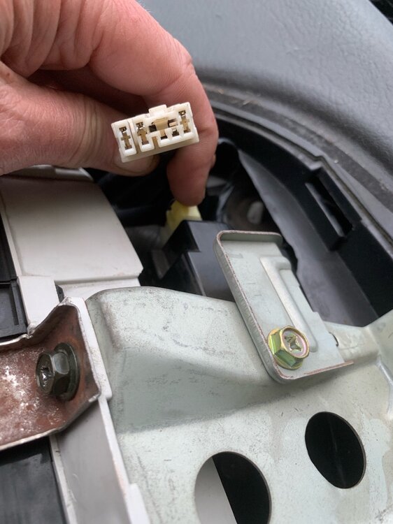

Possible progress. Following the loom around the instruments (ie where I was messing around replacing a bulb yesterday) I found this hanging. Looks like it could be “Intermediate Connector M49” in the HVAC loom, which seems to be vent related. Now I just need to find where it’s supposed to go. Access is a nightmare!
if anybody recognises this and it’s not related please shout! Abandoning till tomorrow morning now.
That connector was down behind the cluster while the cluster and all the pod connectors were still plugged in. There’s nowhere for it to go in either pod, and it’s mot long enough to reach the lighting pod. I suppose it could be an alternative connector for the auto version of the aircon pod? It just seems suspicious that after disturbing the wiring around the cluster I have mode doors not working and a cable disconnected!

No idea what it is, but one thing I do know is it’s not anything I disconnected when I took the cluster out, so it’s either fallen out during the process or it’s always been hanging there. It’s got one of the press-in clips on the side so I can’t see how it could fall out.
I think I can see the wiring connectors to the mode door motor, just trying to get fingers to them to check for security. Really hoping there isn’t a wire broken somewhere inside the loom ?
It’s a red herring. I’ve confirmed I have located the mode control motor and it’s connector, and the connector is firmly in place. But the motor equally firmly refuses to do anything. I think either the motor is dead, the control amp is faulty, or there is a break in the loom. I can’t see how to get access to the motor or amp without taking the entire dash out though.
