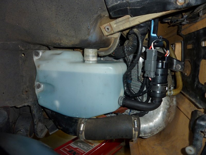

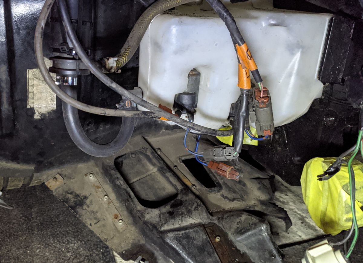

I currently have my intercoolers off my UK spec car and have recently removed the charcoal canister on the passenger side. I was wondering if there are any viable options for swapping out the huge UK spec washer bottle that sits behind the driver side intercooler? I have larger intercoolers so a little extra space would behind them be ideal.

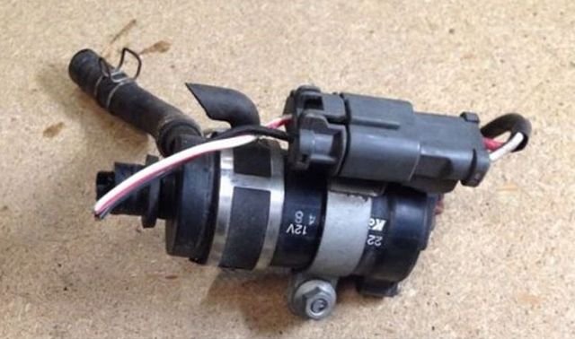

I guess swapping for a JDM spec bottle would mean I lose some washer function? 2 pumps Vs 3?
Thanks
Amazing info. Thank you! Just what I was hoping for.

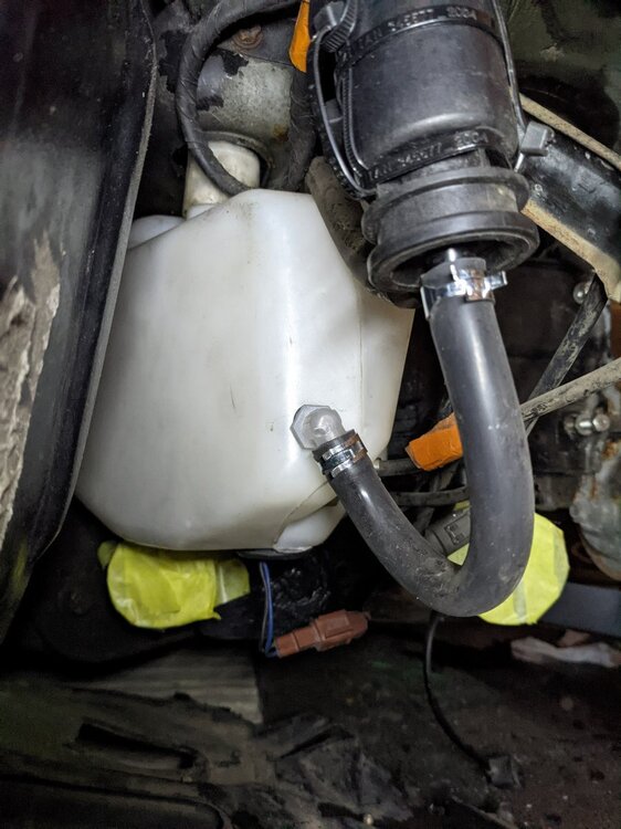

This might be naive but how did you tap into the bottle for the Honda pump?
I like the idea of keeping all 3 washers, even if the headlights are never used and are just an MOT checkbox.

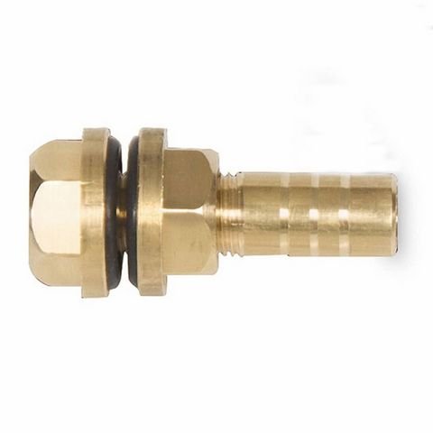

I used the fitting from an old Hozelock garden sprayer. But something like this would do (to suit the internal diameter
of the hose going to the Honda pump).
One word - Genius.....!!
