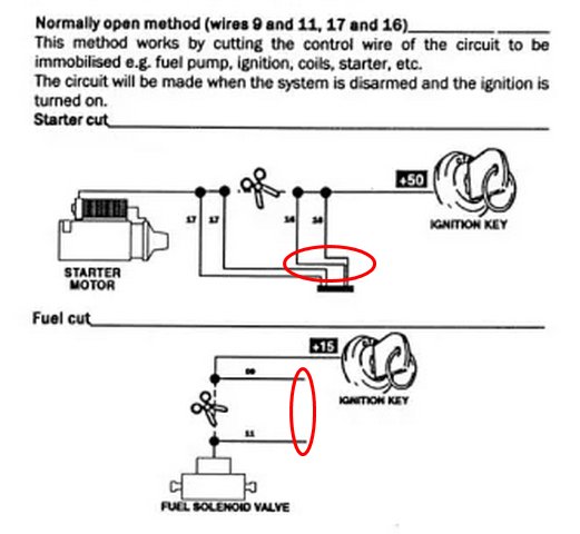

I would probably assume that both fuel pump and starter are wired into the two immobilisation circuits. There are two
relays inside the M999T (see first page of instructions) which make and break the circuits. You could pull the two fuses
3A and 20A (see page four of intructions) and see if that disables the alarm and sets the immobiliser relays to closed
allowing the starter motor and fuel pump to operate. Otherwise you can join the two groups of black immobiliser wires
together inside each of the red circles below to remake the two circuits.
Edited by AndrewG
