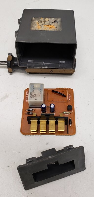

To some, one of the most annoying 'features' of the Z32 is the extra wipe when turning off the windscreen wipers. Here is a solution
published on TT.net.
http://www.twinturbo.net/nissan/300zx/forums/general/view/2645417/New-video-for-the-weekend.html
Details here on how to safely open up the wiper control module located on the RH (OS) inner wing near the firewall.
http://www.twinturbo.net/nissan/300zx/forums/general/view/2645450/It-works-fantastic-Thank-you-for-sorting-this-out.html
