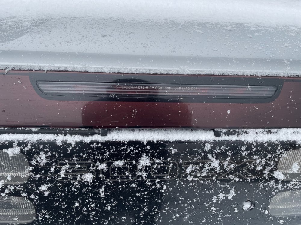

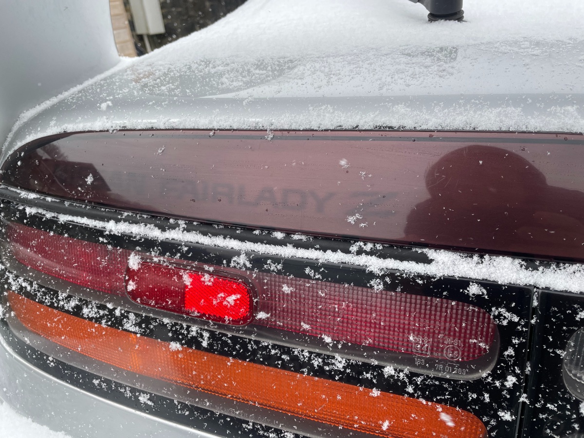

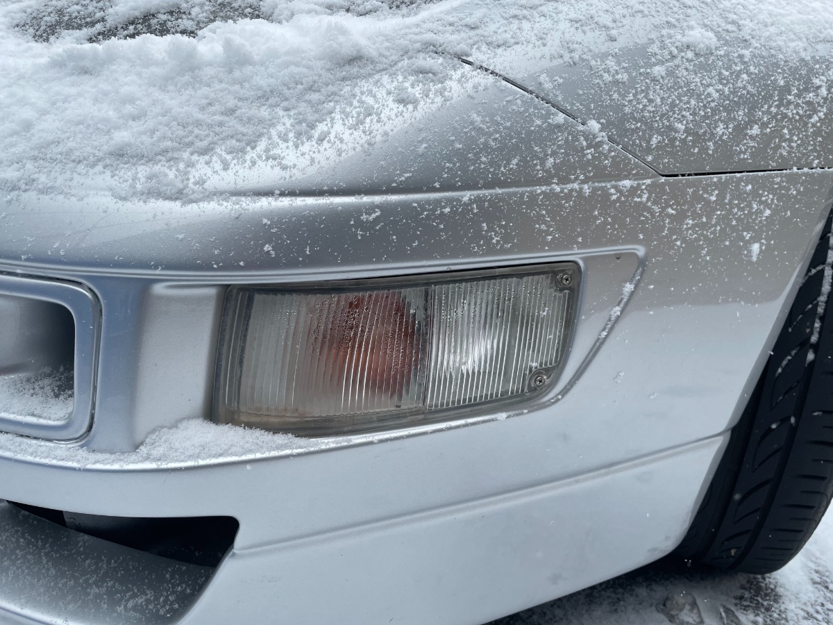

Anyone know what theses indicators are? Just so I know what my options are if I do change them. Also the Perspex strip, I’ve never seen them like that, aren’t  they usually black??‍♂️
The black strip is black when new.
They fade to that colour over the years.
I changed mine 6 years ago.

What an anti climax??. Thanks.
JDM indicators Still available from Japan.
https://www.ebay.co.uk/itm/NISSAN-GENUINE-FAIRLADY-Z32-300ZX-Front-Turn-Corner-Signal-Light-Lamp-Set-JDM/224286715197

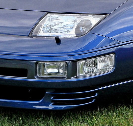

Agreed, but I think they become the best when cleared!
He's going to ask, how have you done that ?.
That’s exactly why I was asking. Thanks.

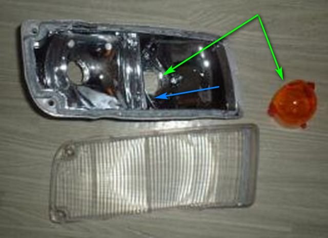

I used method 'B' in the link below. Unfortunately, the images have been lost. However, with the annotated picture I have
added you can work out what's what. Note that the removal of the orange lens is done through the bulb opening on
the back of the assembly (think of key hole surgery). The main clear lens does not need to be removed to do the job. The
photo is simply to show the bits referred to in the article.
The orange lens and its mounted location is arrowed in green, The metal reflector piece location is arrowed in blue (this is
left in place). I used a small Antex soldering iron with a fine tip for the cutting operation. Take great care not to go to far
through the amber lense and hit the front clear lens with the hot tip of the iron. The same goes for touching the plastic bulb
mount area with the shaft of the iron. Take your time.
https://www.pexcom.com.au/z32cms/e107_plugins/content/content.php?content.448
If you have a 99 spec bumper then the previous years lights dont fit
You can only have the ribbed 99 spec lights on the front bumper
True, but did you look at the OP's first post?

Black ones are UK type. They're dummy indicators. The true indicators for UK type are inner with sidelight and indicator side by side on the front side of bumper. The black doesn't fade, at least on my 92.
