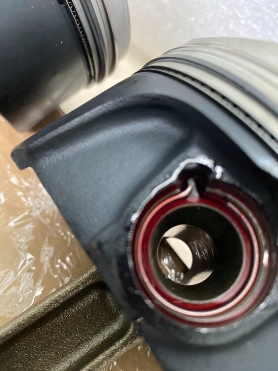

  • Engine case half built.

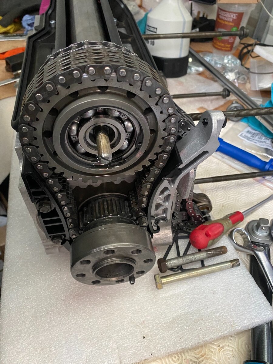

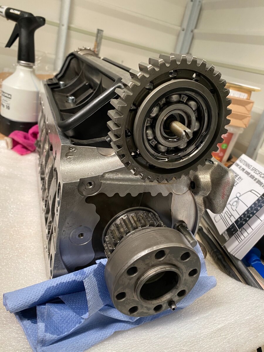

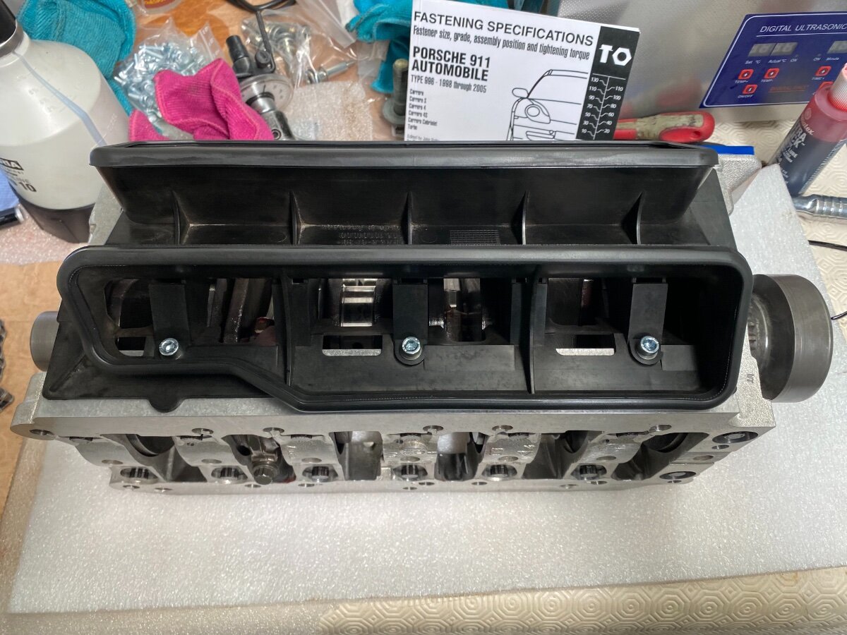

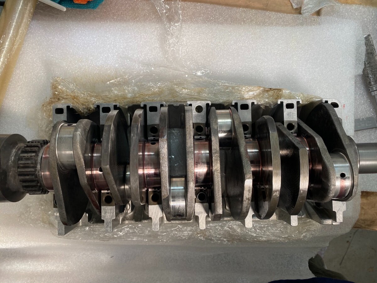

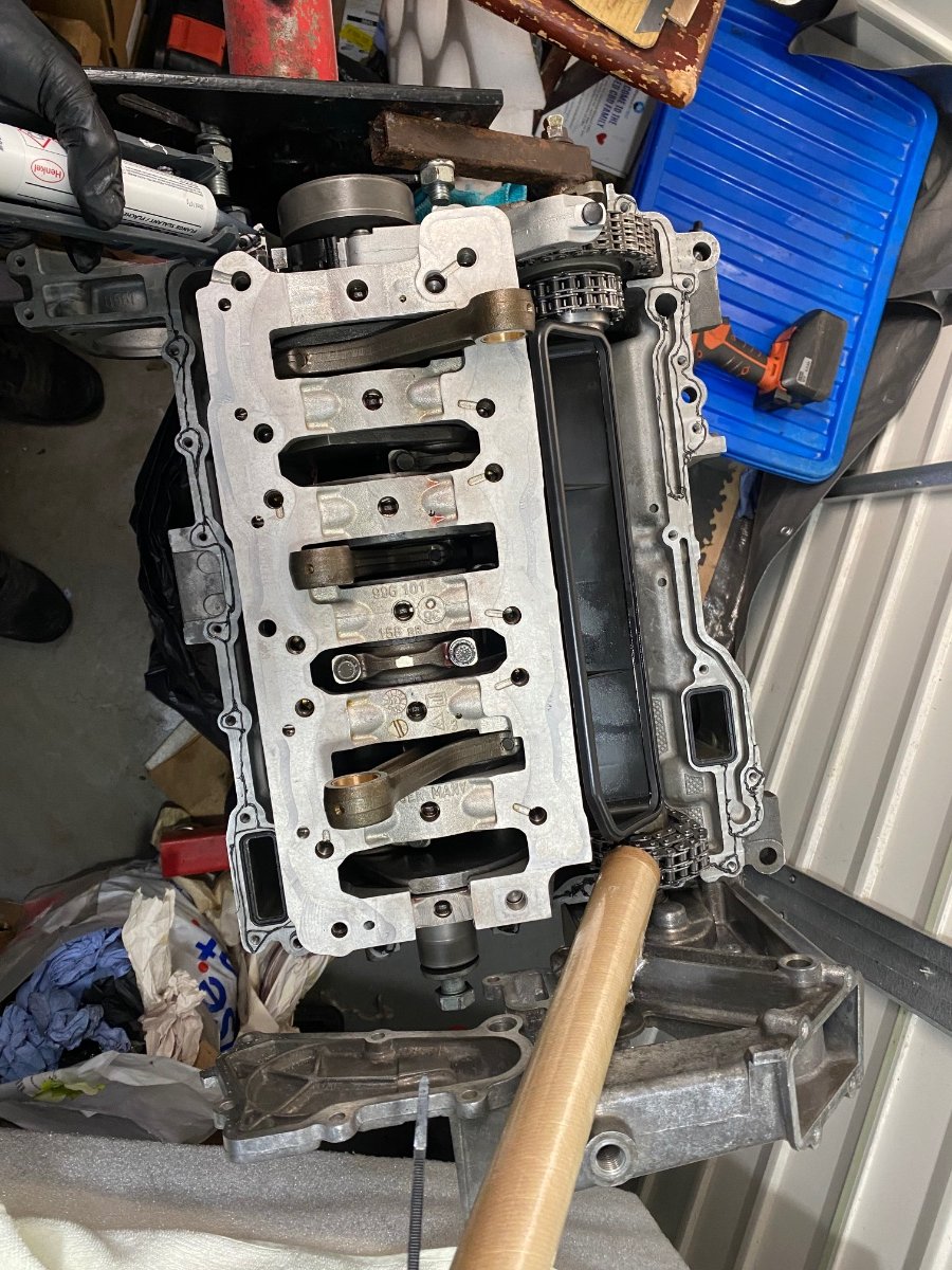

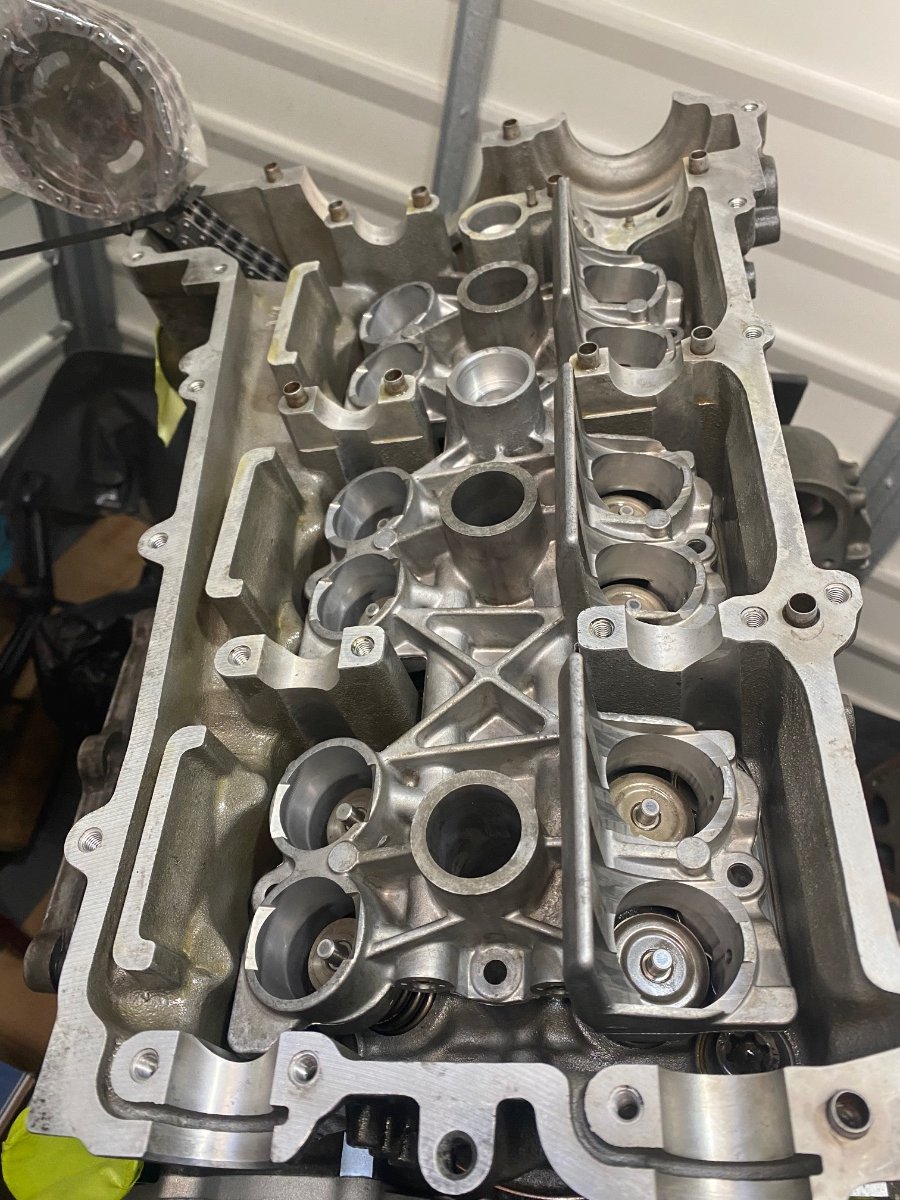

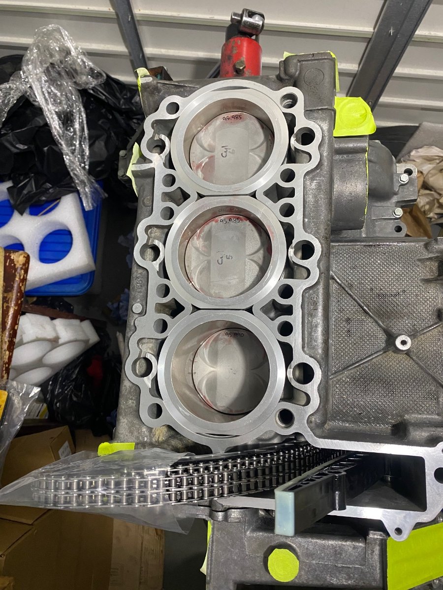

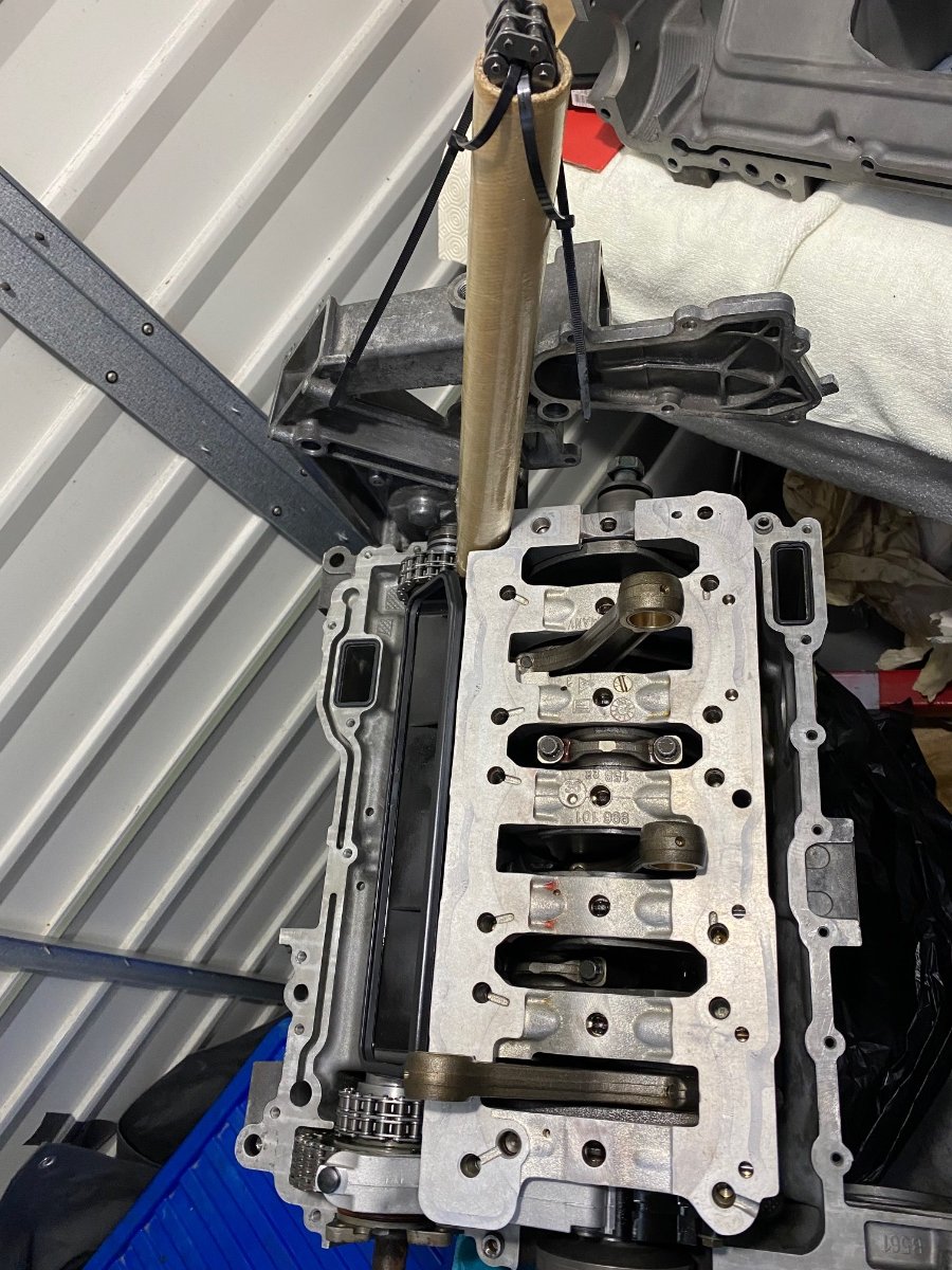

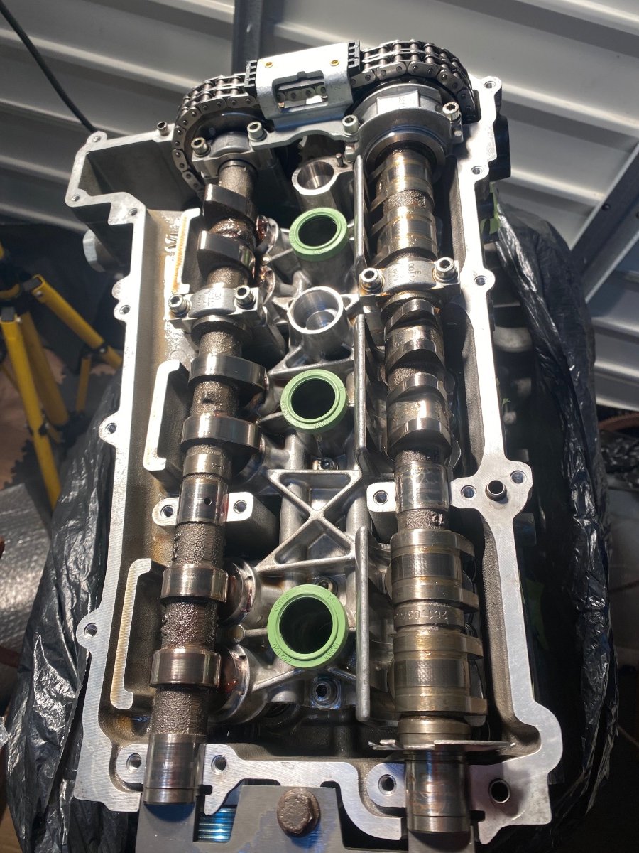

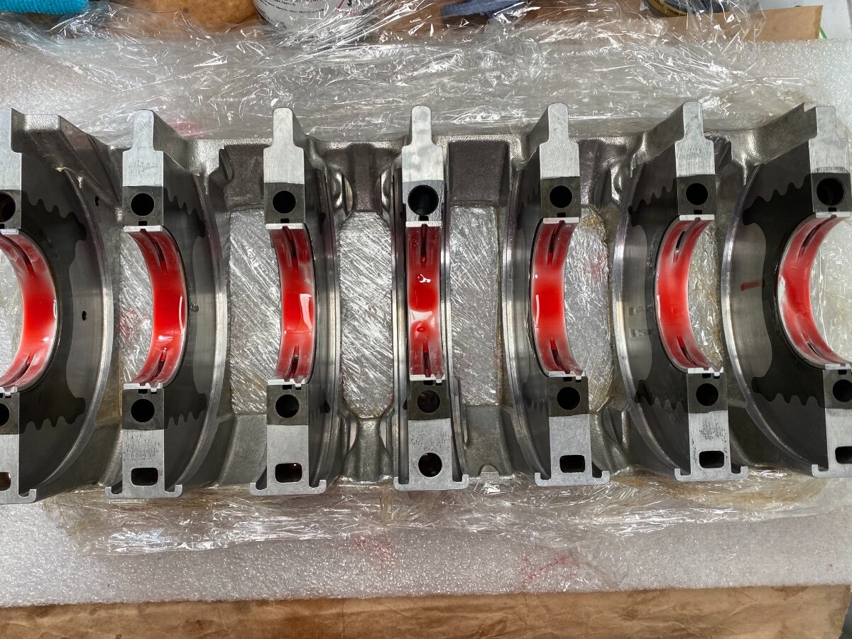

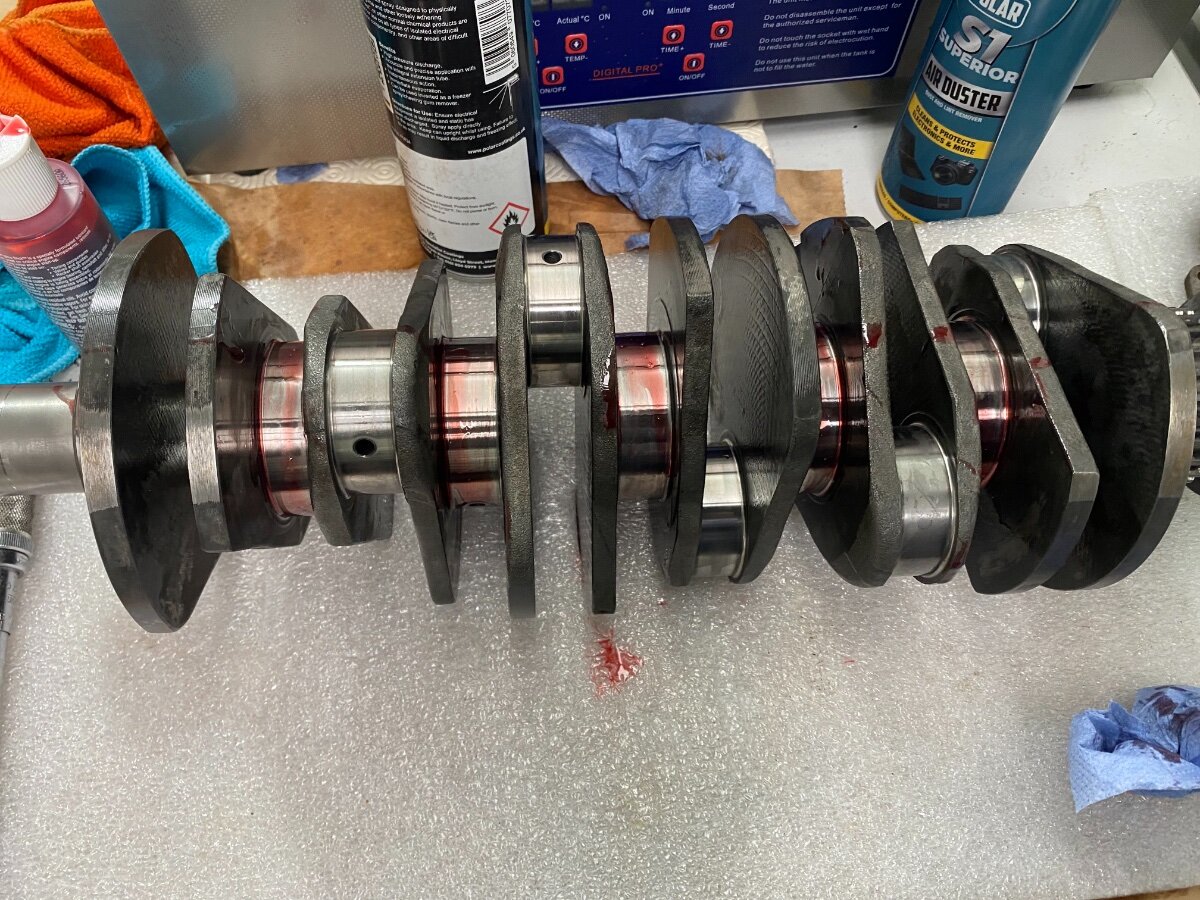

Bit of an update, cleaning sure takes a long time.
Crank carrier back together, just waiting on the new chains to arrive before putting it in.

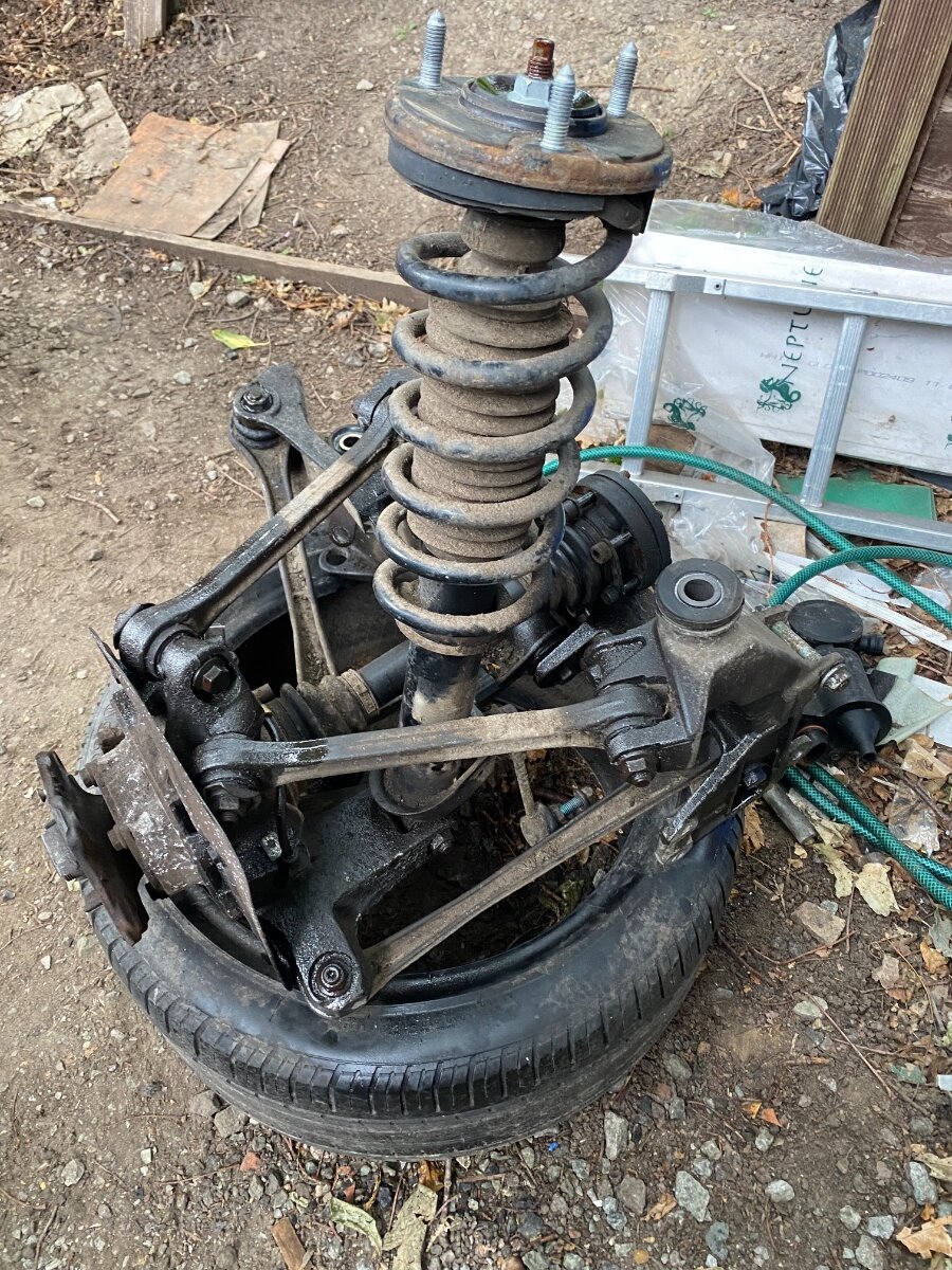

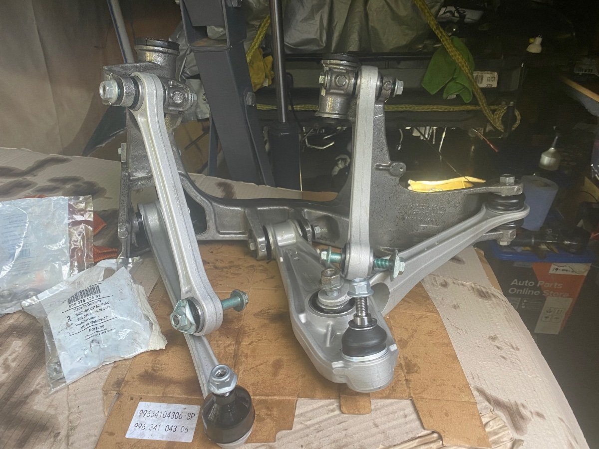

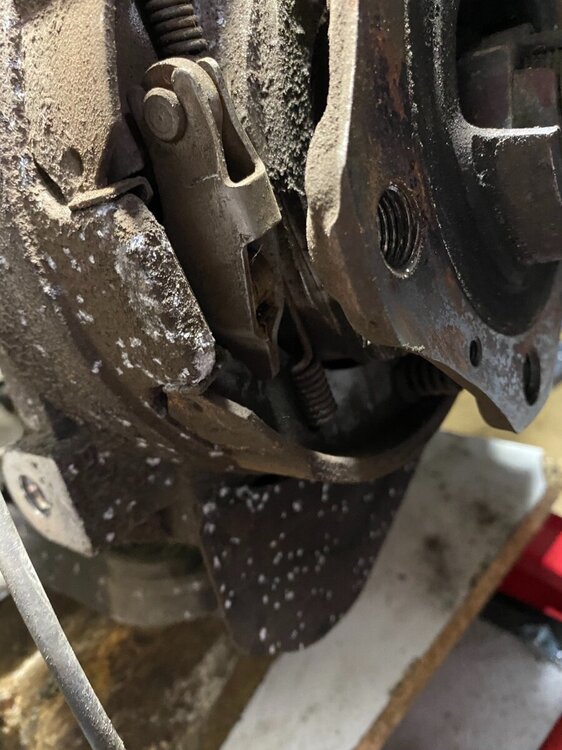

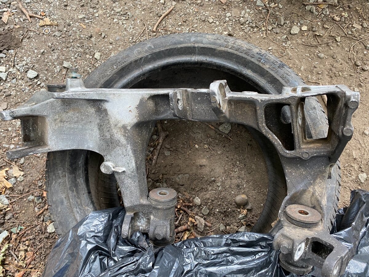

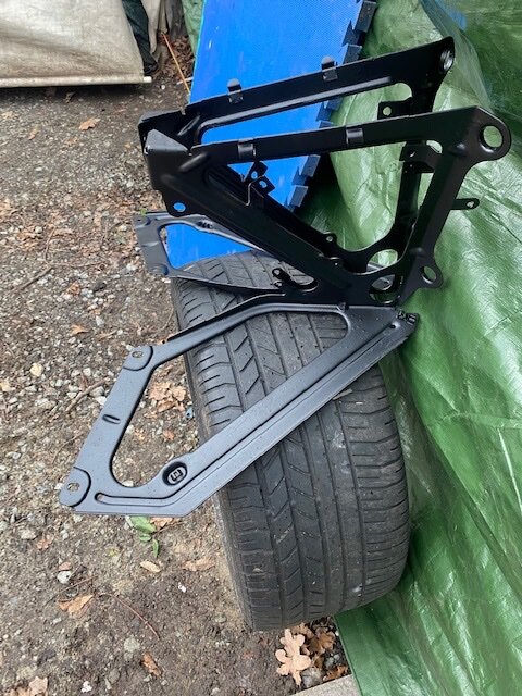

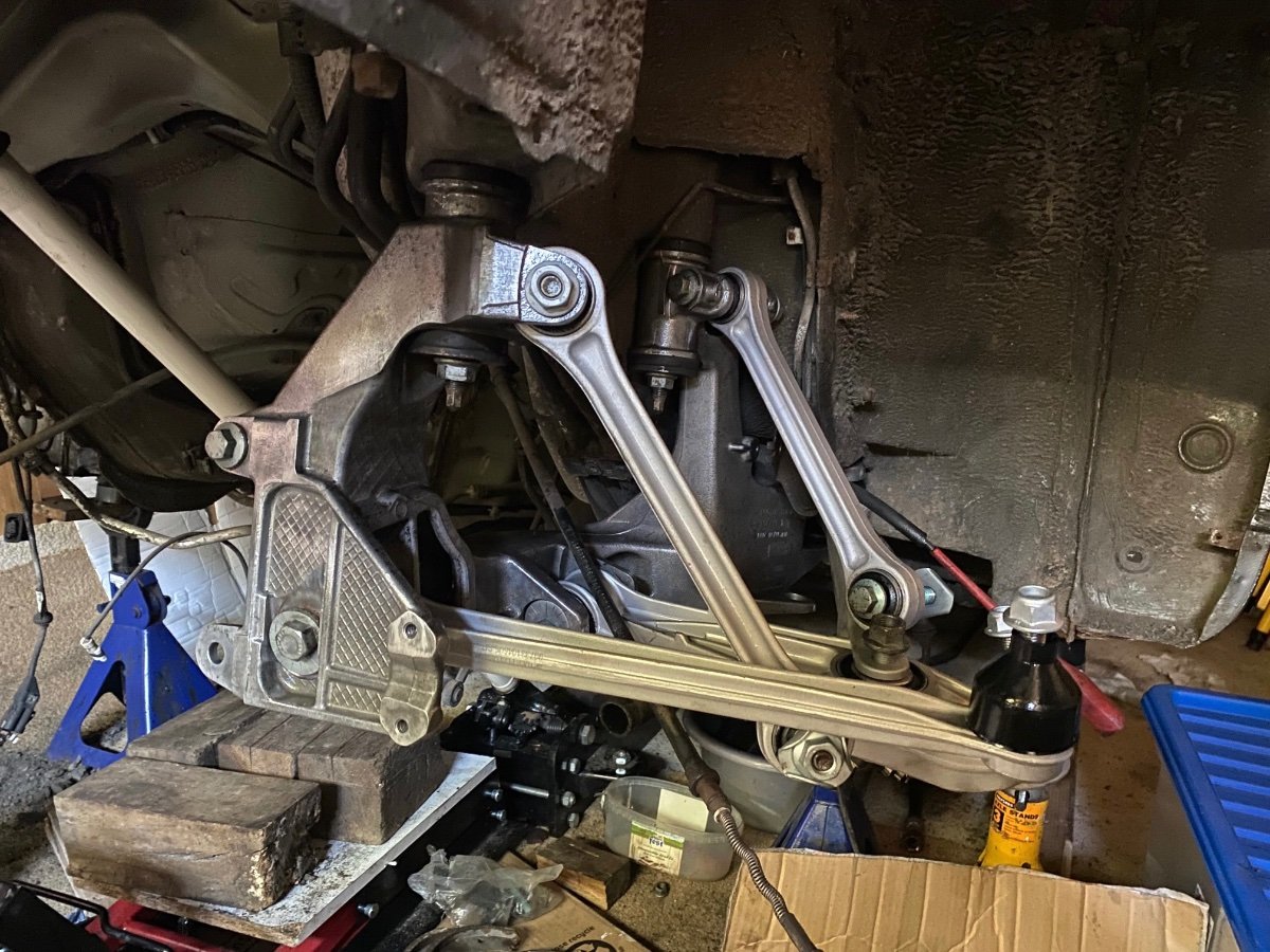

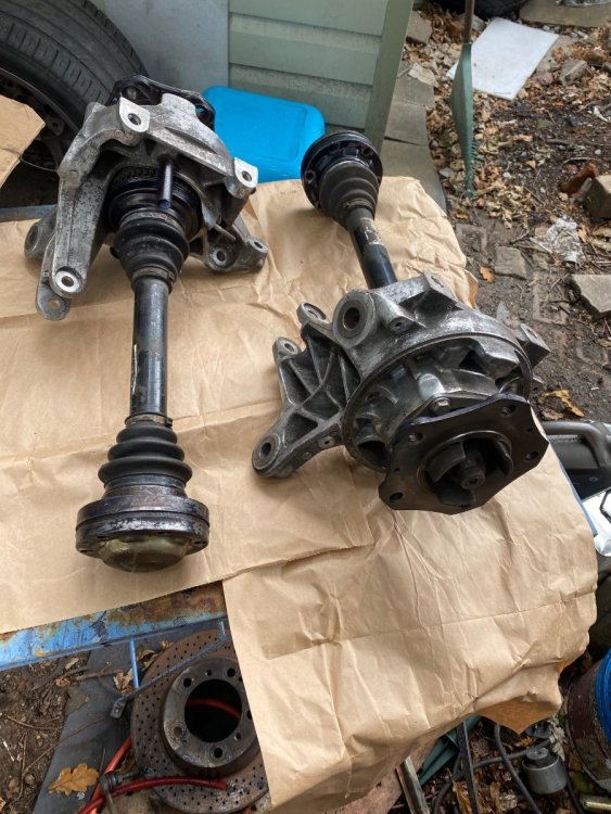

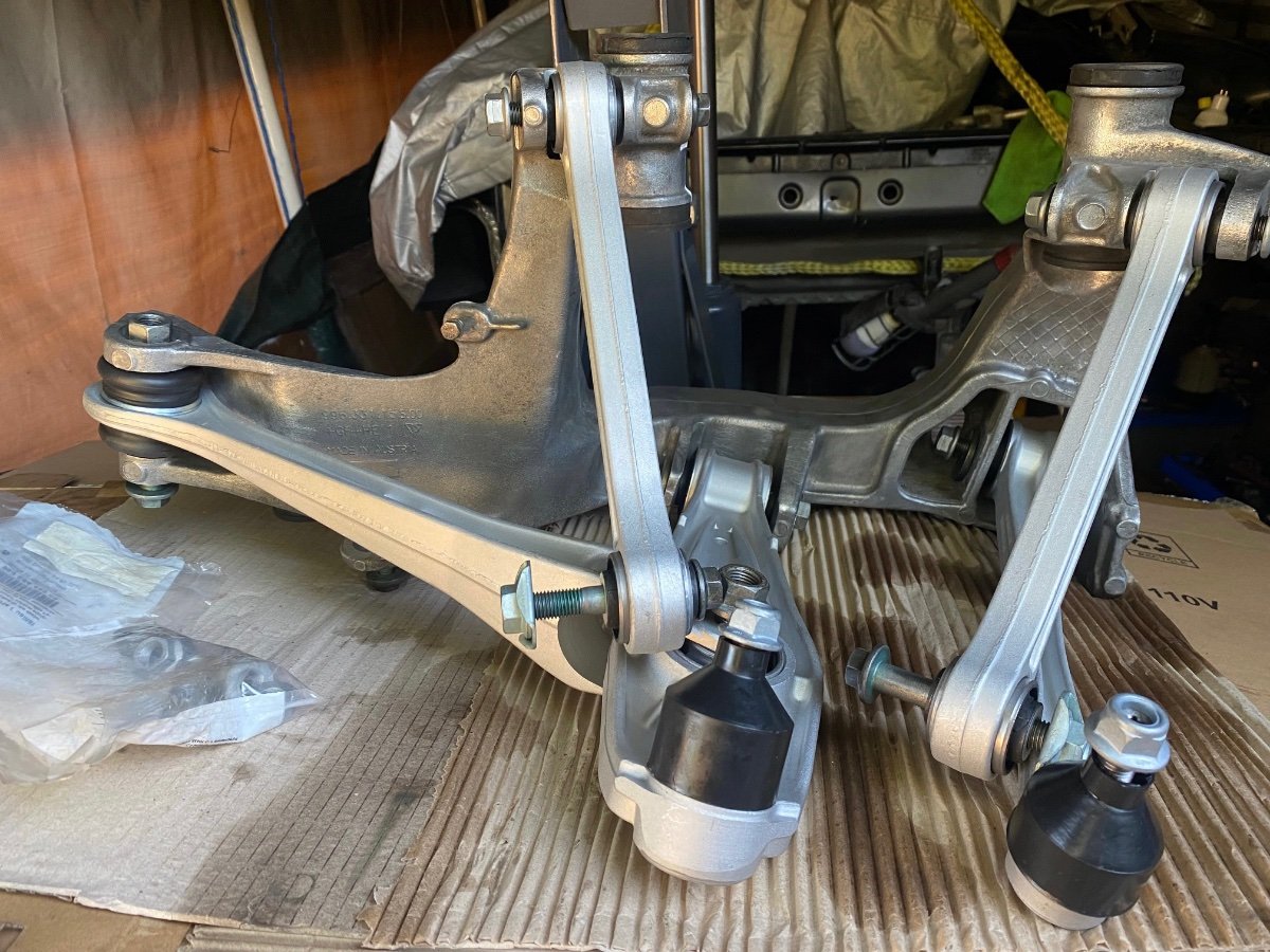

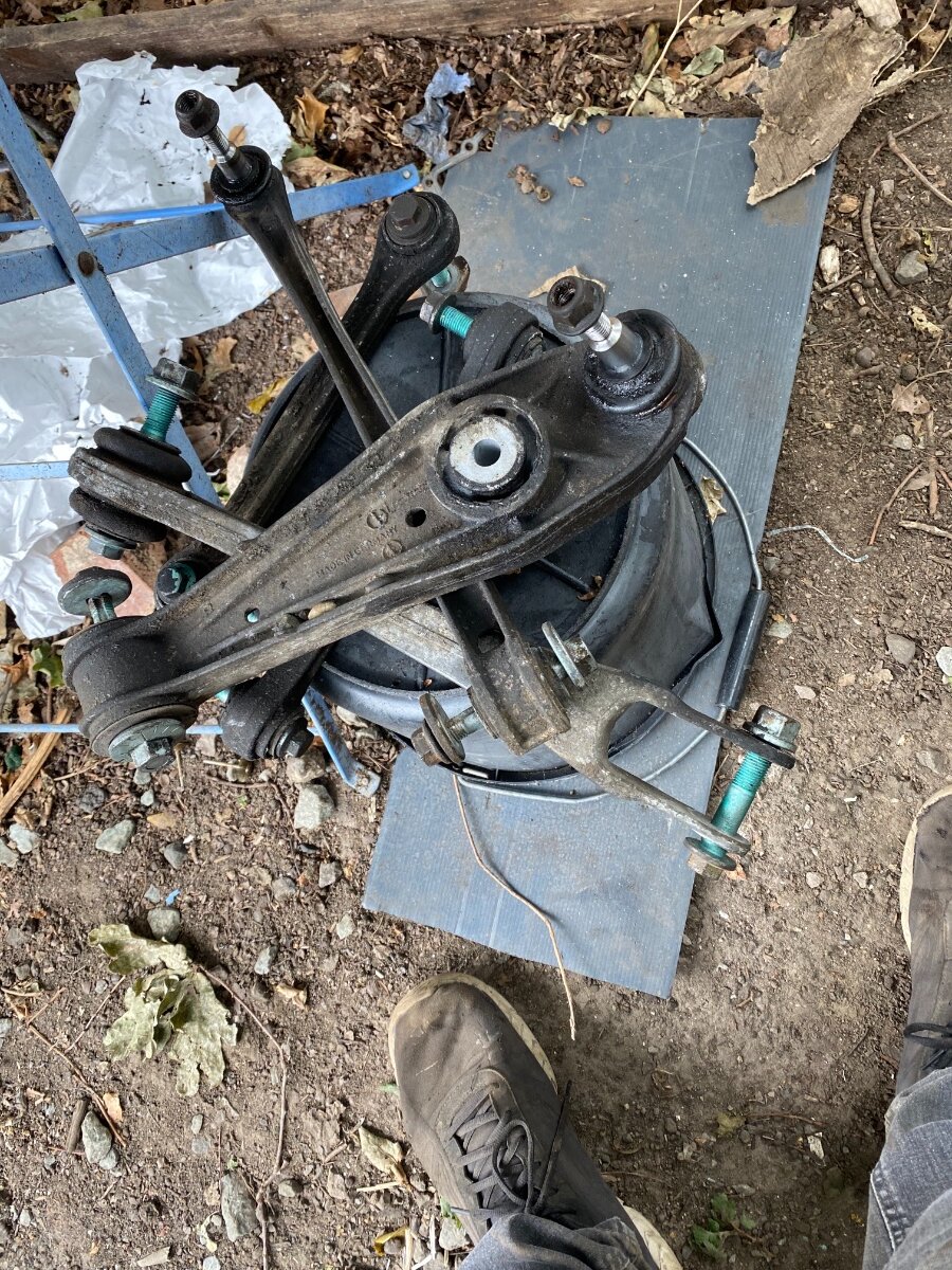

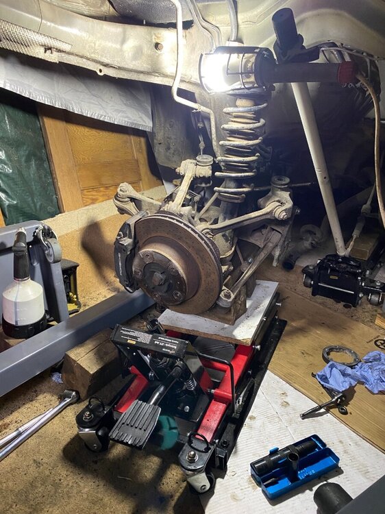

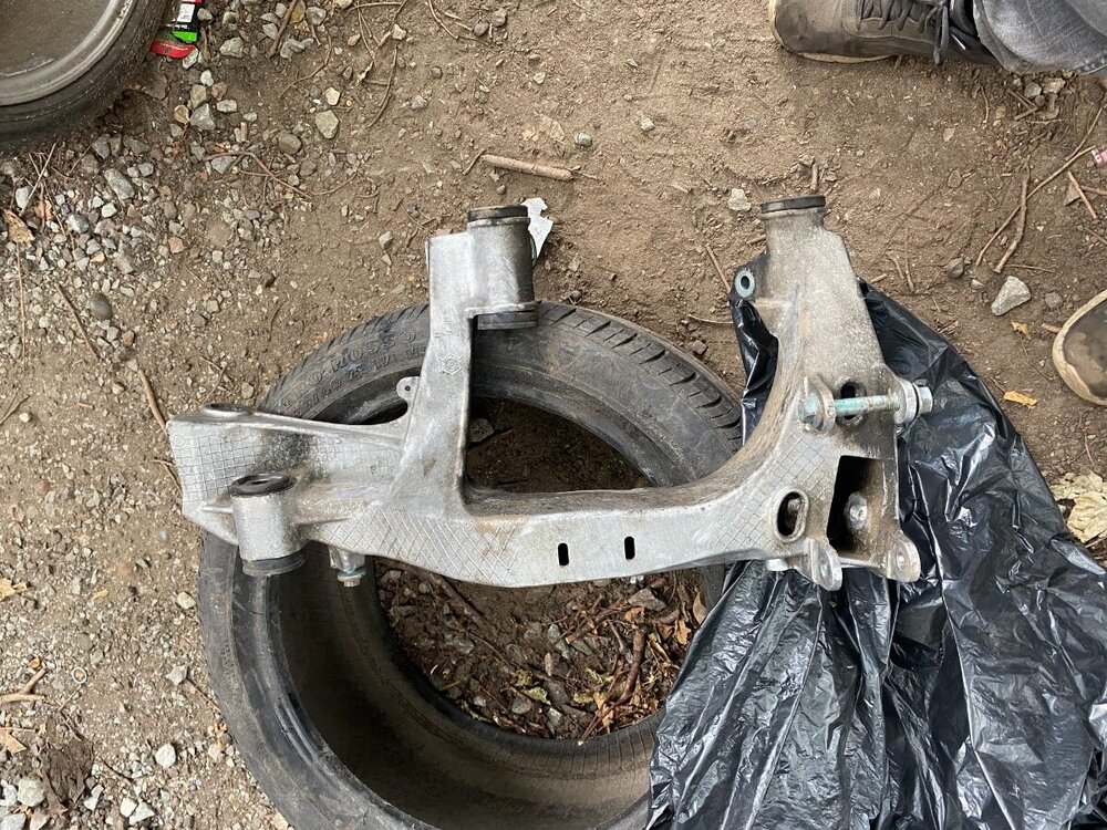

I am going to replace all the suspension arms, not cheap. I had fun trying to get the passenger assembly out, the main problem is releasing the handbrake cable.
CEB6F8C0-BA8F-4B32-87E4-4BE2031BA728.thumb.jpeg.080956292d873408f709cfbec8c2ab32.jpeg5FB21612-48BF-4B6D-9F05-92EB22AC8818.thumb.jpeg.1b9d5d7c07193d5b22f3fd68558c32bd.jpegF175D686-C005-4F34-9A3E-33E7F32F616B.thumb.jpeg.4882e1e8ce0e7cff8e420cfb70b05f79.jpeg

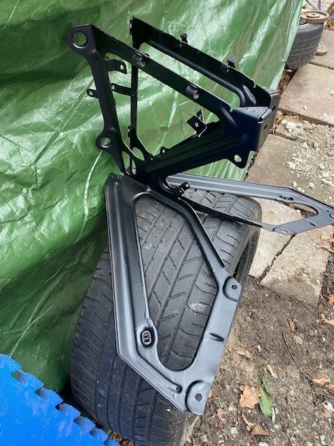

Drivers side stripped down, new arms coming tomorrow, bit more cleaning to do.

2 hours ago, AndrewG said:
Why are you replacing the suspension arms?
Unfortunately there are parts that can only be refurbished by a place in Czech Republic, exchange surcharge, pain in the neck.
This throw away society is horrendous.

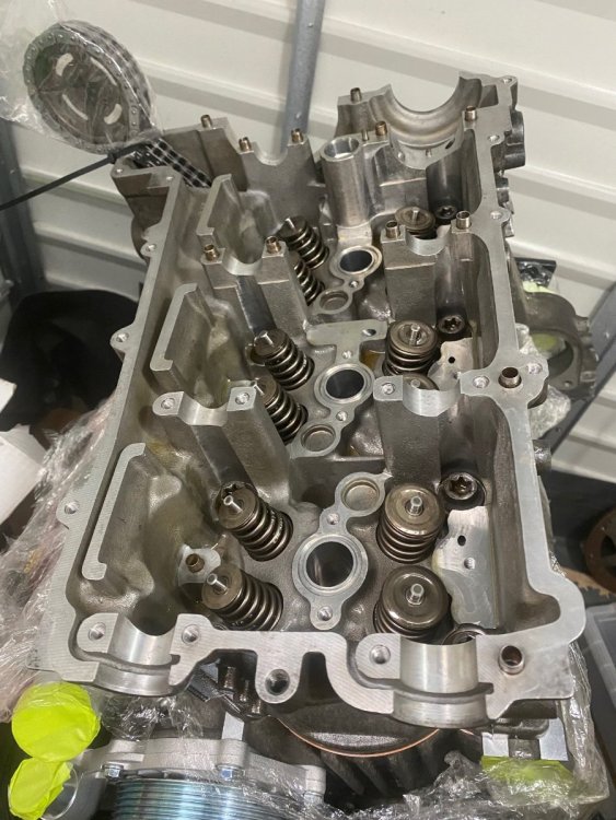

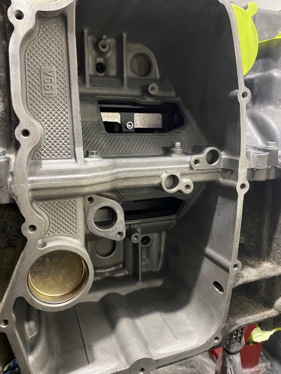

Engine case half built.1B1A80A1-C2DF-4F54-968B-16A0BBC186E9.thumb.jpeg.f65053668538d978f401009d99ffede2.jpeg1BED208D-EABA-4935-90EA-48DF56F867BF.thumb.jpeg.aa868cff5f1d2e831cb392b67bd9d430.jpeg3C00E3EA-7483-4EE3-9162-5D7153CB9060.thumb.jpeg.fdf377bc81f863a99140208dbe041d21.jpeg0B750C73-F7D4-480C-8D63-FC4C2B302FF4.thumb.jpeg.d2bcb26ab88c3a101cad40d7c722a39d.jpegF0AF718A-428E-472F-9771-34FA8F8172E1.thumb.jpeg.af3f5d6f92761a34025a87978f6d9868.jpegD2B395B2-9DAE-48E0-84D9-DD7CEA491483.thumb.jpeg.eb72c26f3fe936691ce091a1fb96c81b.jpeg778A1C9E-787F-49C0-974C-DFAC0EF9F5DA.thumb.jpeg.84fc0a8b0b0f89501e65ccfd30f3e7e5.jpeg356F6F39-4D31-4135-AE11-90F7301DDBC3.thumb.jpeg.8d63c83ea006afd491b5523e1de295df.jpegC3C2E06C-107C-413E-A313-5A041DD36F0C.thumb.jpeg.56b4118eae75bfe133289e077cd56b00.jpeg

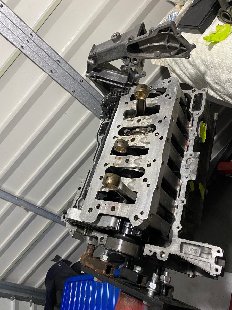

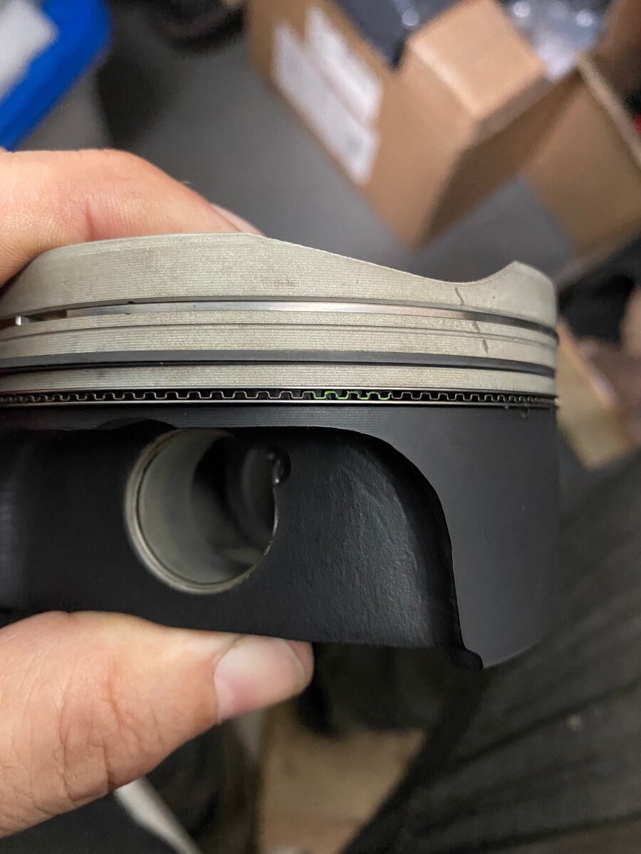

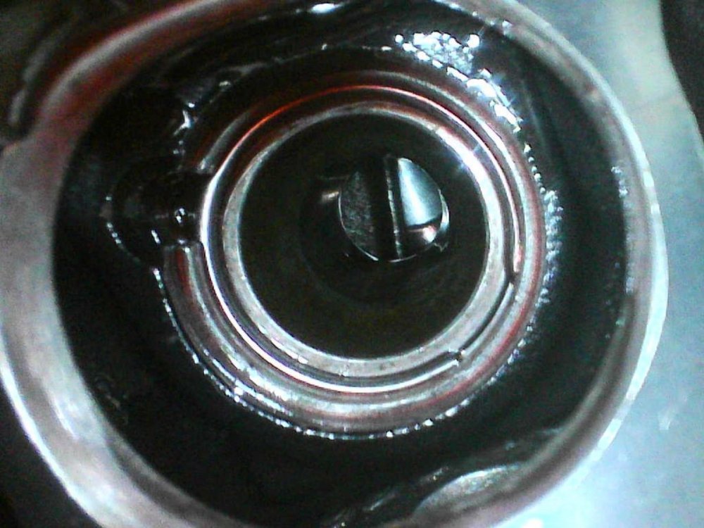

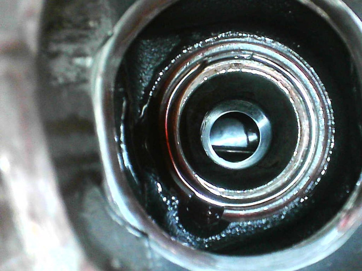

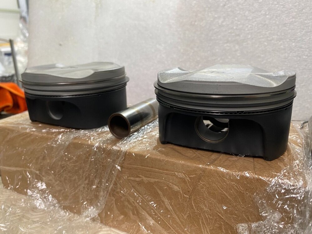

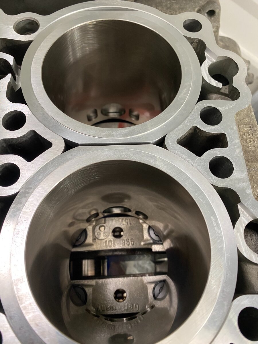

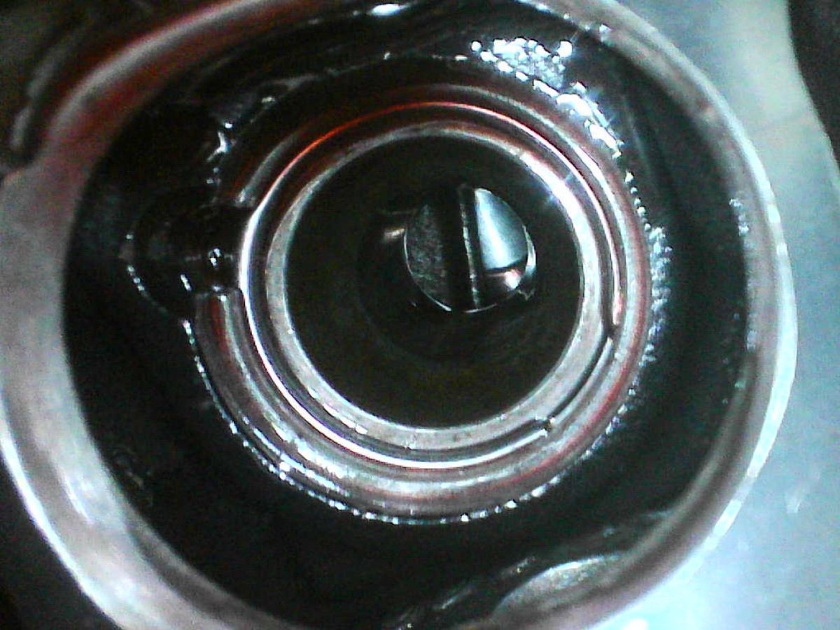

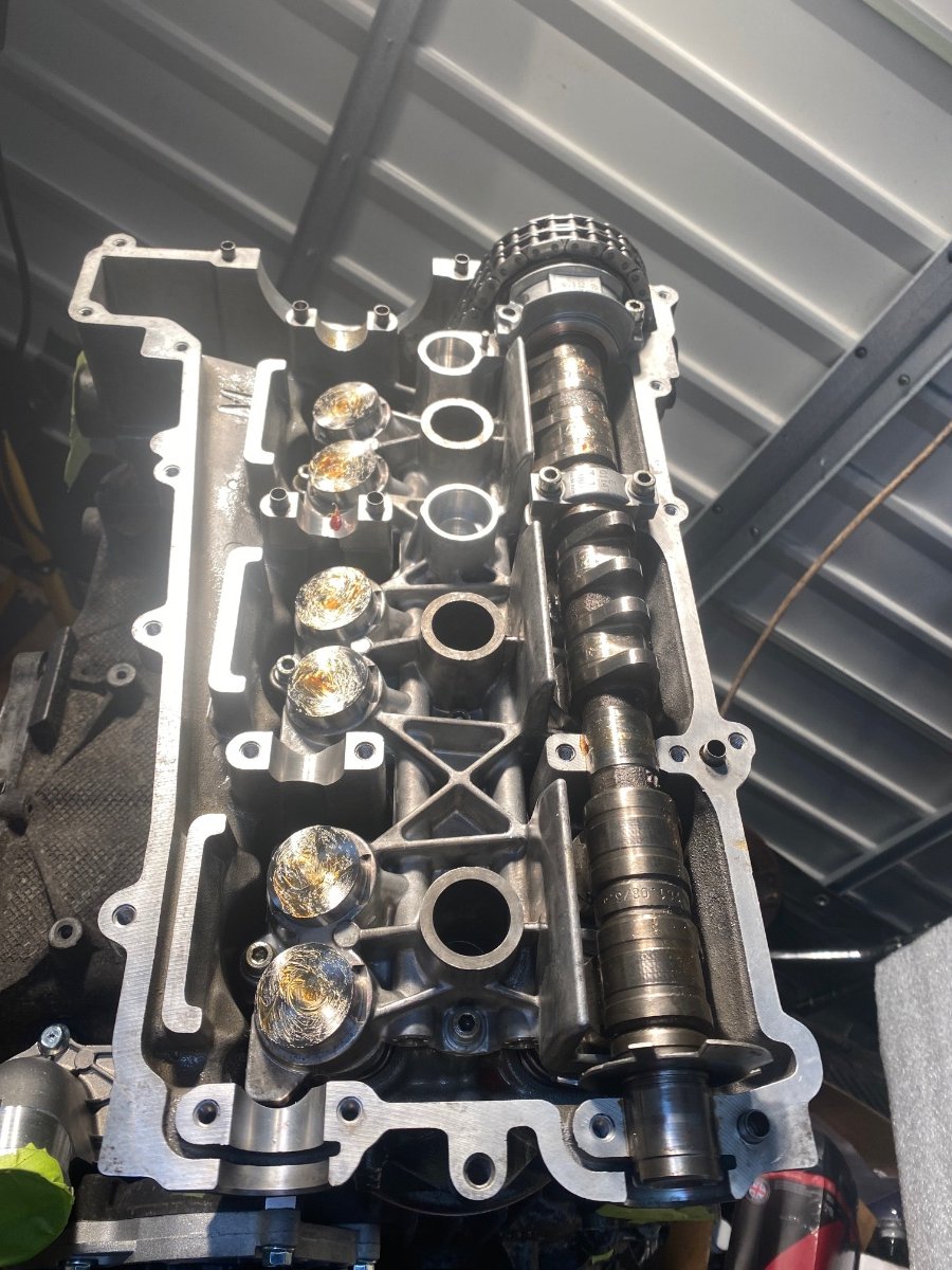

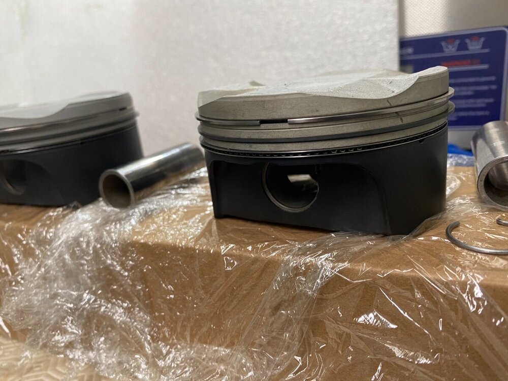

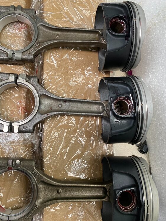

Managed to get the other half of the engine together, you have five minutes before the sealent goes off. It is a harder task because you have to put the piston in then turn it upside down, look through a small hole, knock piston up till it lines up with the piston rod, put gudgen pin in then the clip blindly in. Made my own tool.

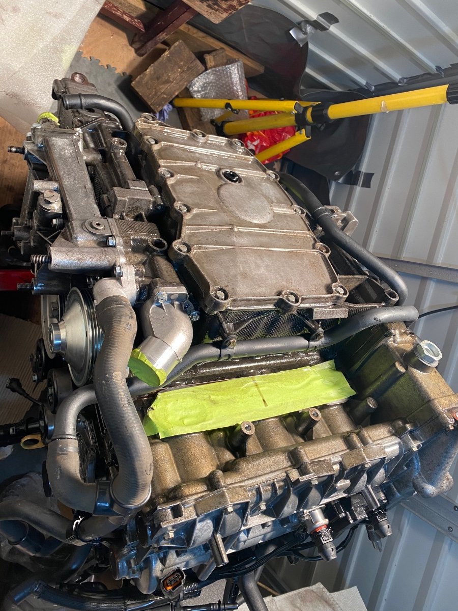

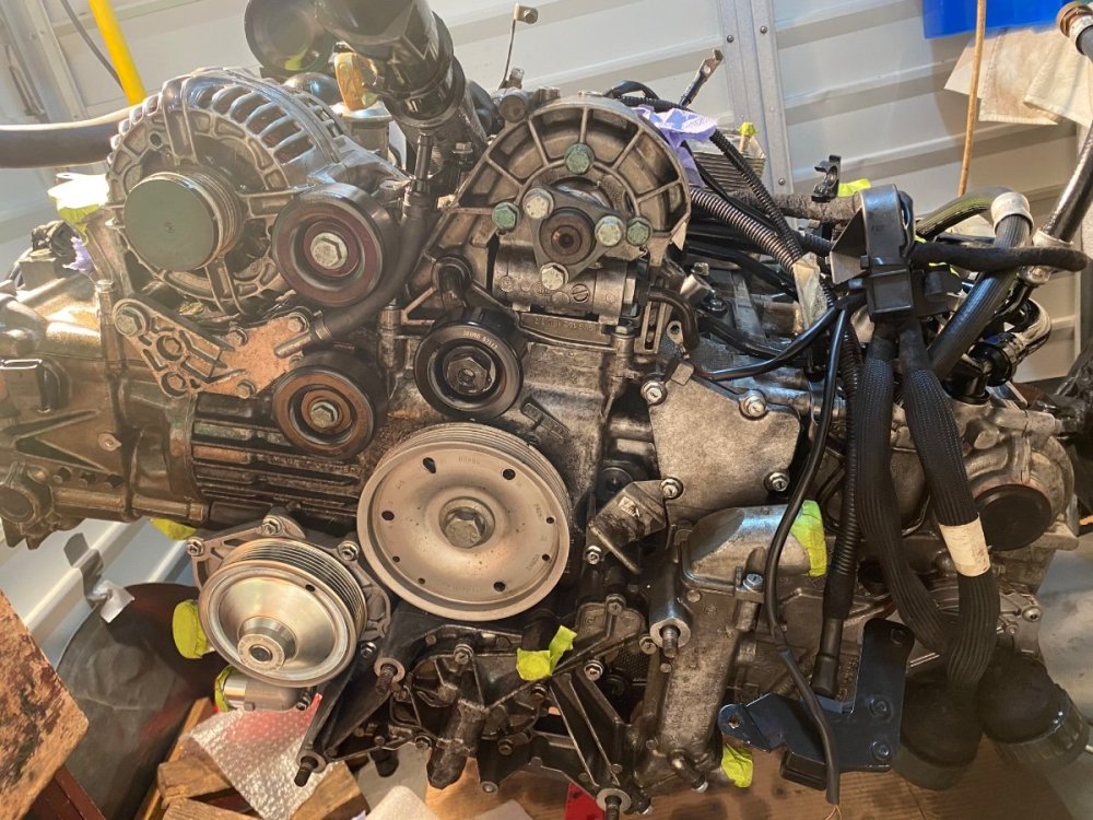

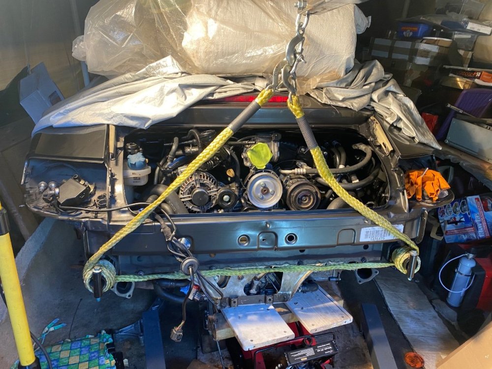

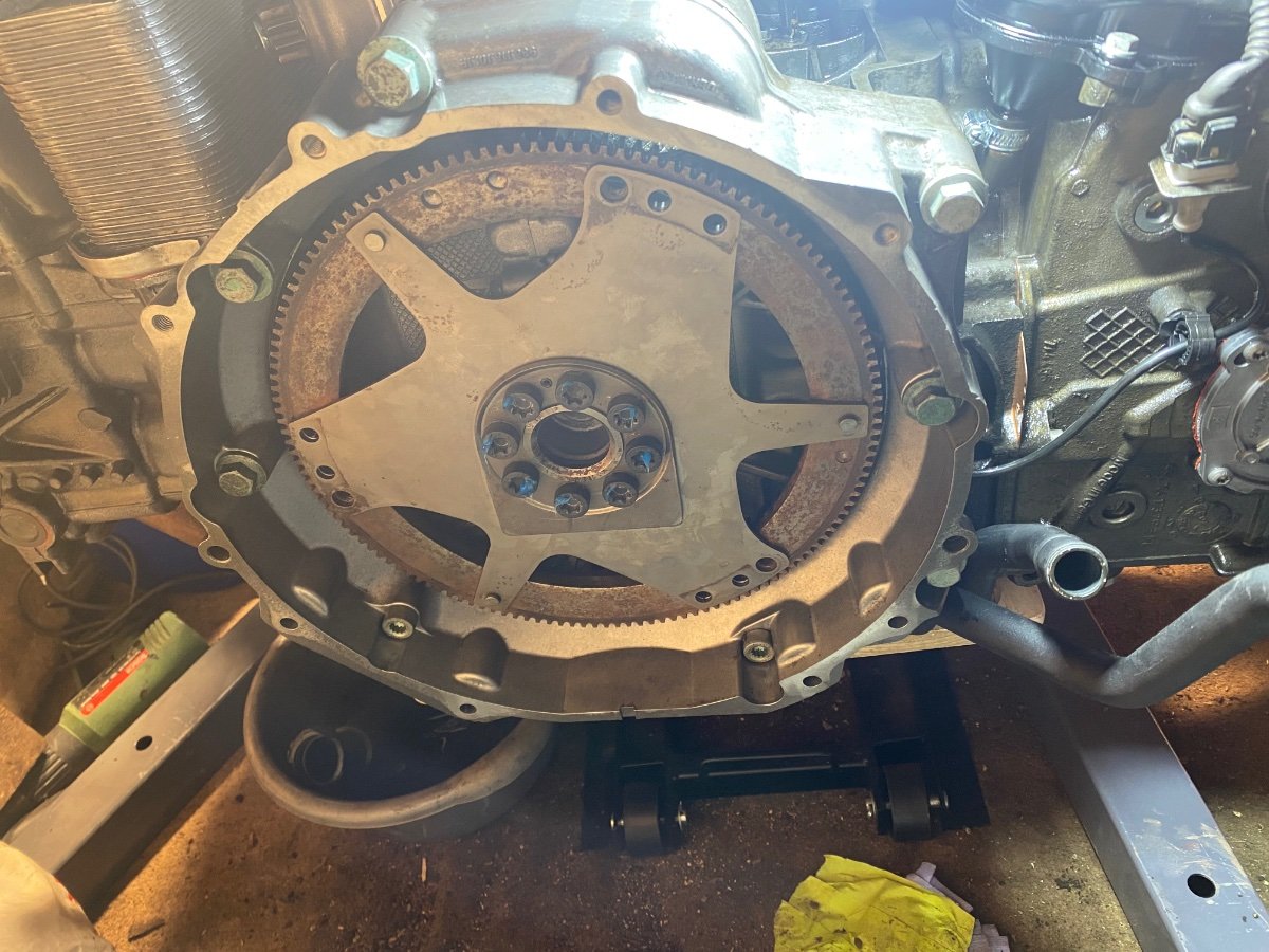

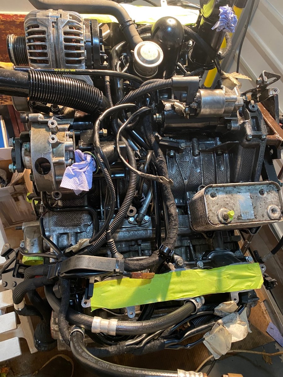

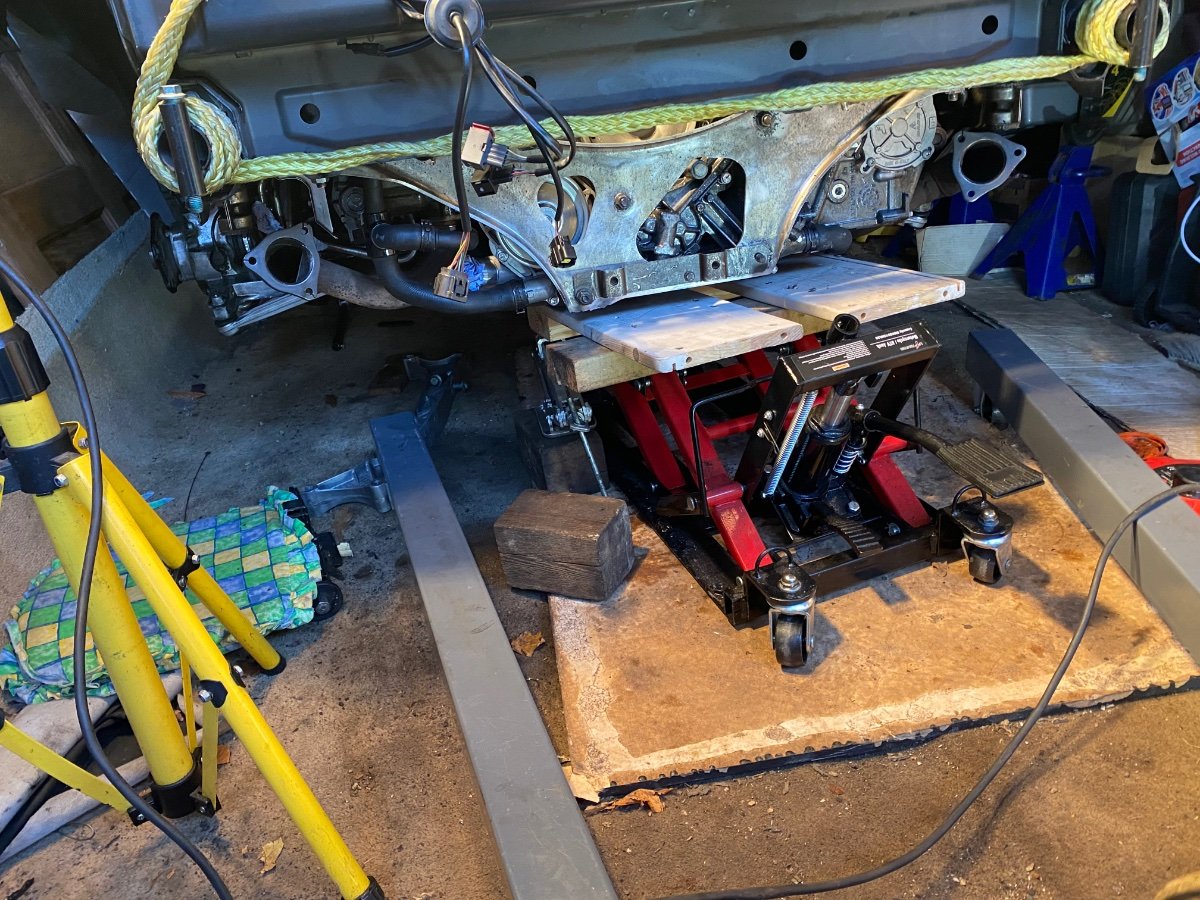

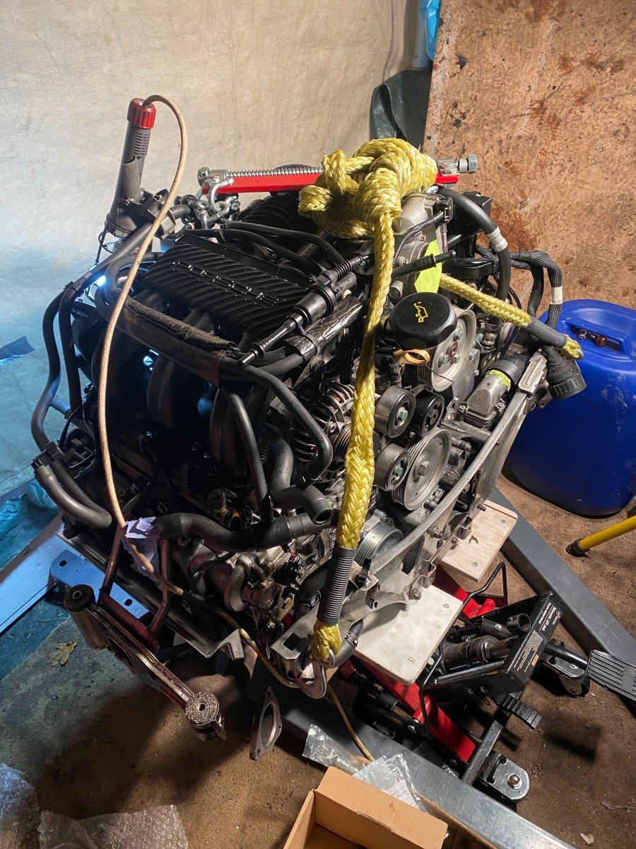

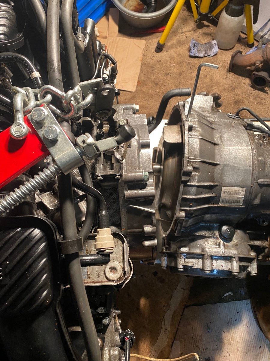

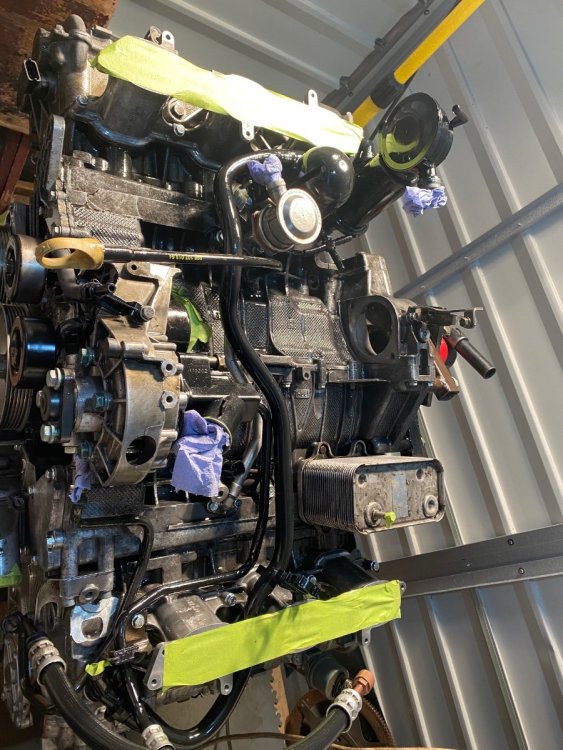

I have been busy with finishing the engine, it is now back together with gearbox. We slid the engine on the ATV jack made a trolly for gearbox, then lowered the car with the engine hoist.
432AE297-0176-48BC-968E-4D39063766FC.thumb.jpeg.3e7b1e025acc603a84b8bcaa6789adcc.jpeg389A3F35-2204-4D5A-98AF-0DB6316BDAE8.thumb.jpeg.276876733198c0023674de04e5e1b2c7.jpeg8C44726B-4C6A-4C8A-8407-0F5031E5FCC1.thumb.jpeg.6939f8e97f022b4e57abb541bd011f5c.jpeg7918D4CD-516C-427B-9D7E-EE23C0ACF6CB.thumb.jpeg.e0bfc8c2a6a38480682cf21005900706.jpeg12556D2C-D6E1-4B9A-A0CC-82F08748C3CC.thumb.jpeg.31a76b8cd06fe76cbb25bc9ef0900549.jpegE37040DD-AA7A-45B8-A10F-1782461902F3.thumb.jpeg.6e956ff7874fa0fc7c31cc3b196211de.jpeg6524AF08-70FD-486C-8C91-DE5517E0F903.thumb.jpeg.d87e12679e81a6e858d16412d4573151.jpeg

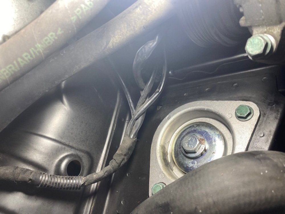

Connected everything up that had to be just in case it went “bang”. Was scared.
cleaned engine bay, nice new brembo brakes to fit.

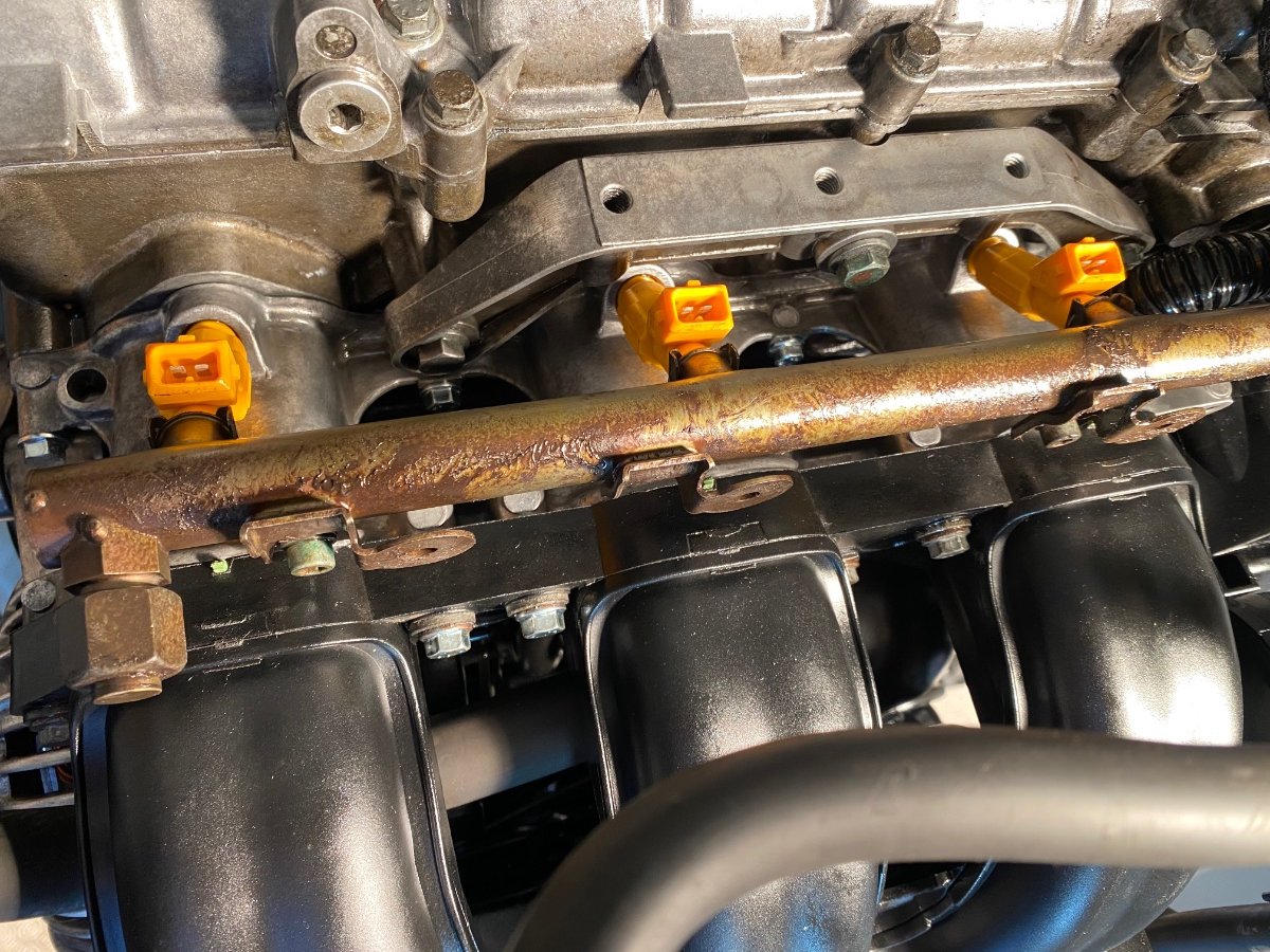

So in January we had a problem, the car ran great but as soon as it was put into gear, it coughed and spluttered. Working with a tech on the 911 forum we tried everything, tested all electrics, MAF needed replacing, did find that 1 of pre cat O2 sensors was faulty car has 4 sensors, got a proper blowtorch and changed them, found a few air leaks sorted them but still no joy, seemed better but as soon as you put your foot on the gas under load it was over fuelling.
The other problem was the car came with an incorrect ECU and Alarm so I had to purchase one from a scrappy.
Alarm bells should have rung at that stage, but it looked so nice lol.
Couple of weeks passed and after tearing my few remaining hairs out, the Tech guy said you built the engine it was not a heard of problem and we never had the car running before we touched it.
He said
{This is the difference between normal faults and Induced faults .. an Induced one is something that has happened during work on the car .. as such .. it's a bitch to find !!
Imagine engine out .. lots of bits replaced .. back in an issue .. if you have replaced one item and this happens you know what it is .. when many .. it becomes difficult .. probably the worst fault to find regardless !! }
We can have the same issues at times and we do this for a living .. not every new part actually works so being told its a new maf etc ..
Doesn't mean anything in my book ... long process of elimination follows.
So over dinner one night my brother asked me had I checked the injectors were correct, I said do you think I’m stupid of course I checked the code numbers. He said that I had complained to him I did not like how they seated in the when installed.
I showed him the order and he said straight away there wrong.
Well I was devastated. So 5hrs later and a lot of searching for the old ones we put them in was a pig of a job.
Car started and everything was good.

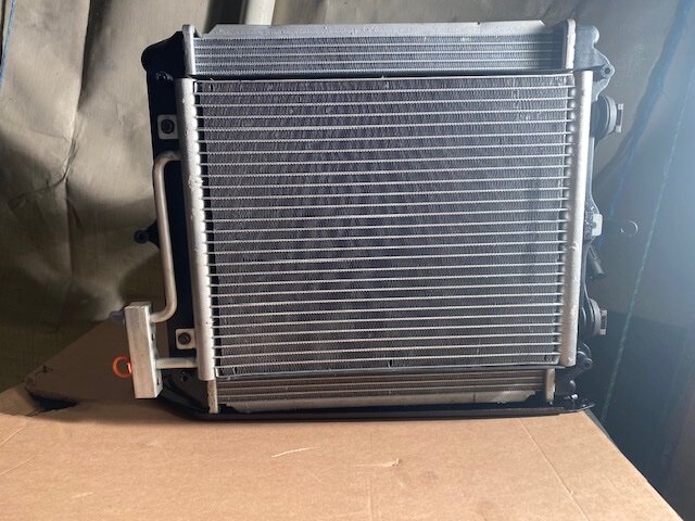

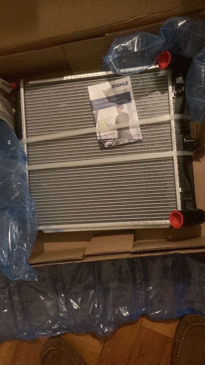

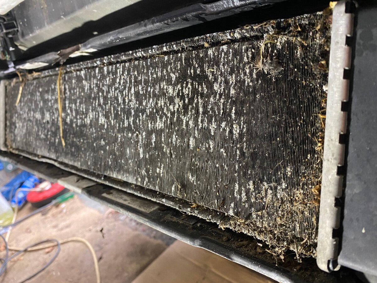

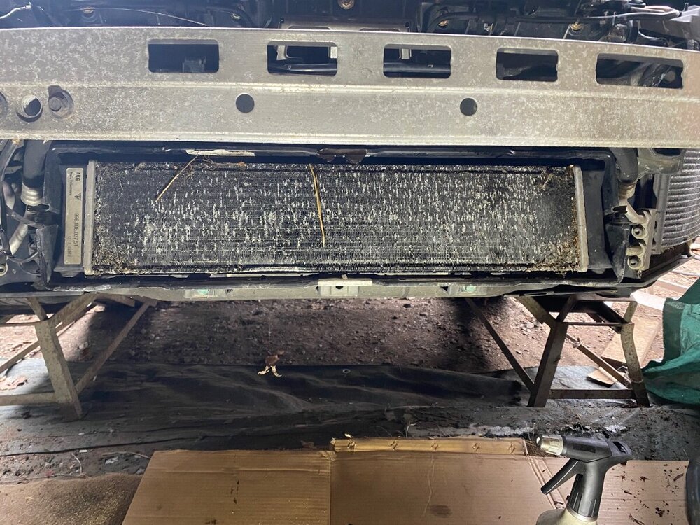

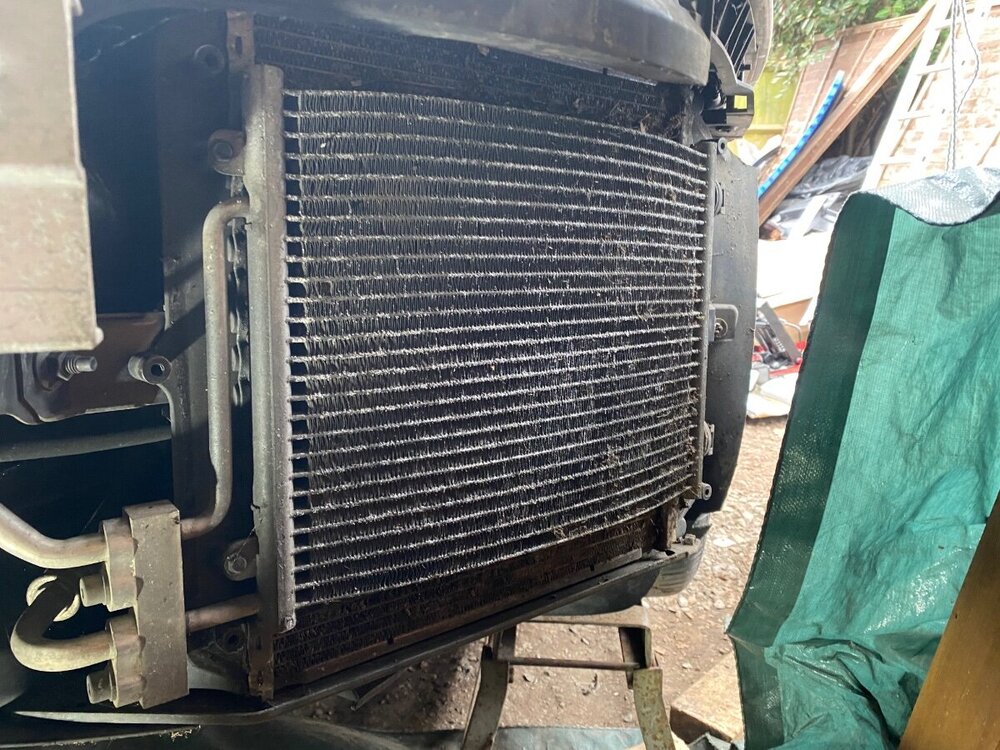

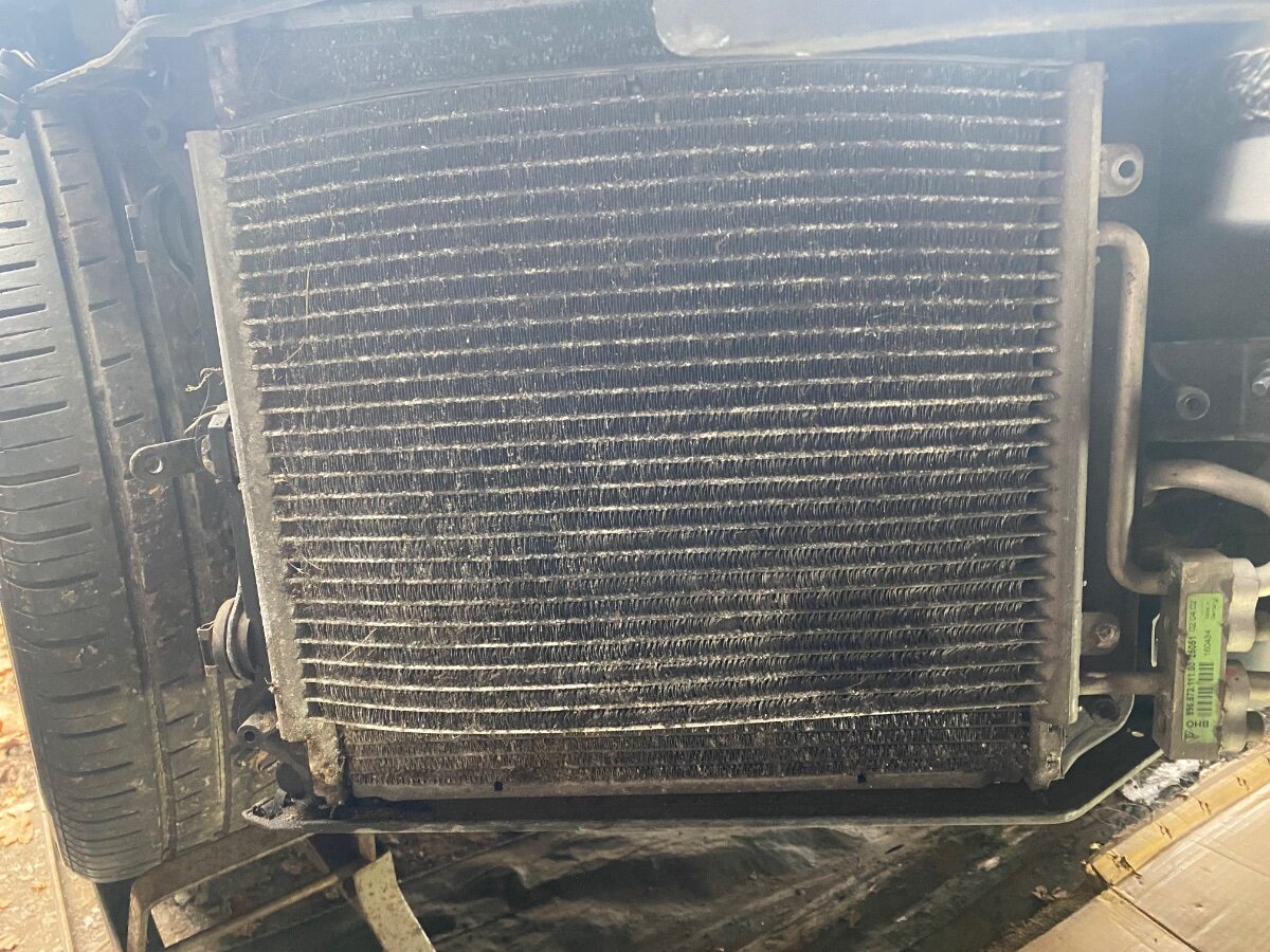

I took the front bumper off, looked at the rads they were all original so I am going to change them.
I could not believe there is 3 cooling rads and 2 air con rads. What a joke.
Still waiting on centre rad from Germany.

16 minutes ago, AndrewG said:
Were the new injectors letting air in from not being seated correctly?
Hi they were a little but the main factor was the fuel rate was to slow, thus ECU over fuelling to correct but couldn’t.

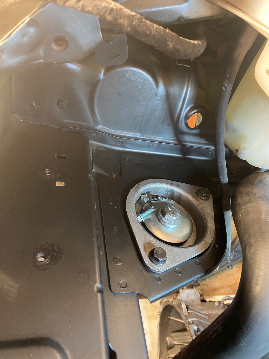

Front of car all cleaned up, new rads fitted and everything sprayed with Dinitrol  Corroheat 4010 great product.
