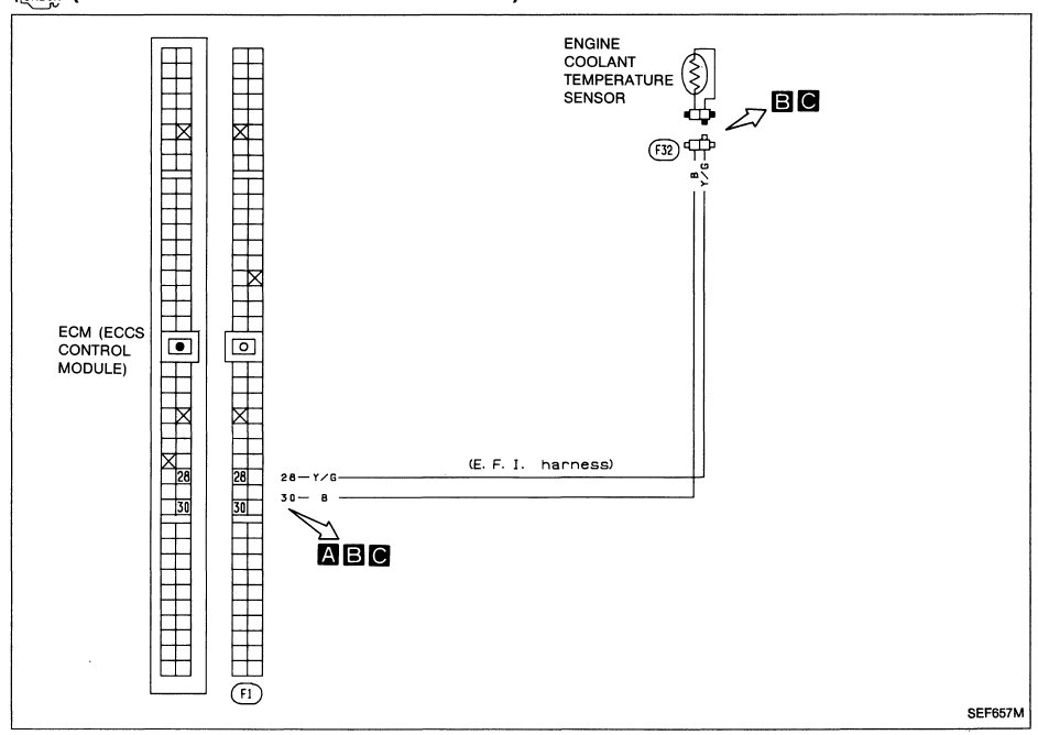

ECU fault code 13 and Aux Fan (the small electric fan in front of the radiator) running is symptomatic of faulty ECU temp sensor. You can check
the EC code here:
http://www.twinturbo.net/nissan/300zx/forums/technical/view/1105629/The-Ultimate-Guide-to-ECU-Diagnostics.html
Your photo shows just one wire connected to the engine temp sensor, there should be two to form the circuit (see below).
FSM Diagnostics for code 13 and faulty ECU temp sensor circuit here:
EFEC 115.pdf
