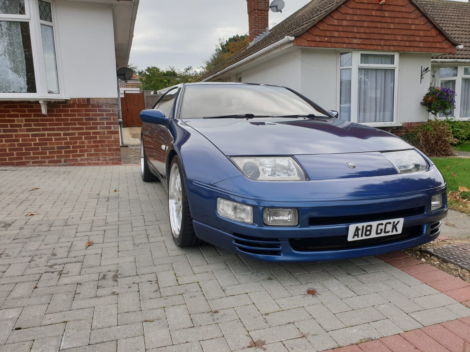

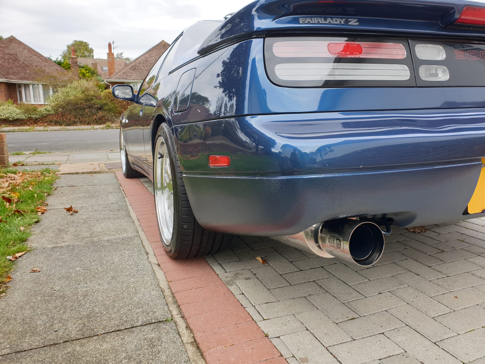

Hi, no I just bought ET35 offset rear wheels and ET25 fronts with no spacers, both sets 18” wheels. But as someone earlier mentioned, you can just plonk on some 10mm hubcentric spacers on the rears, and that should sort your problem out, much cheaper than buying a new set of wheels. I’ve attached some photos so you can see the fitment.

Ah yeah you’re right about the spacers. My car when it had the old veilsides fitted, had a set of driftworks hubcentric 15mm spacers on the front, which had studs on the spacer itself, so solved that issue. Just checked the driftworks website and turns out they don’t do 10mm hubcentric ones, only slip on ones which you want to avoid at all costs.
But to be honest, you’re probably right in the issue being solely to do with geometry, after lowering the car, so probs best the OP checks geometry first.
