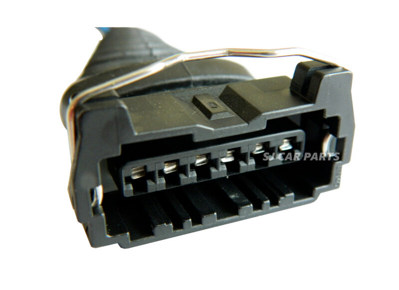

I am a bit worried about the MAF connector though because it's easily disconnected even with the spring clip in place, might be a good idea for a cheeky cable tie?
It is mate, double checked when I was at it yesterday.
