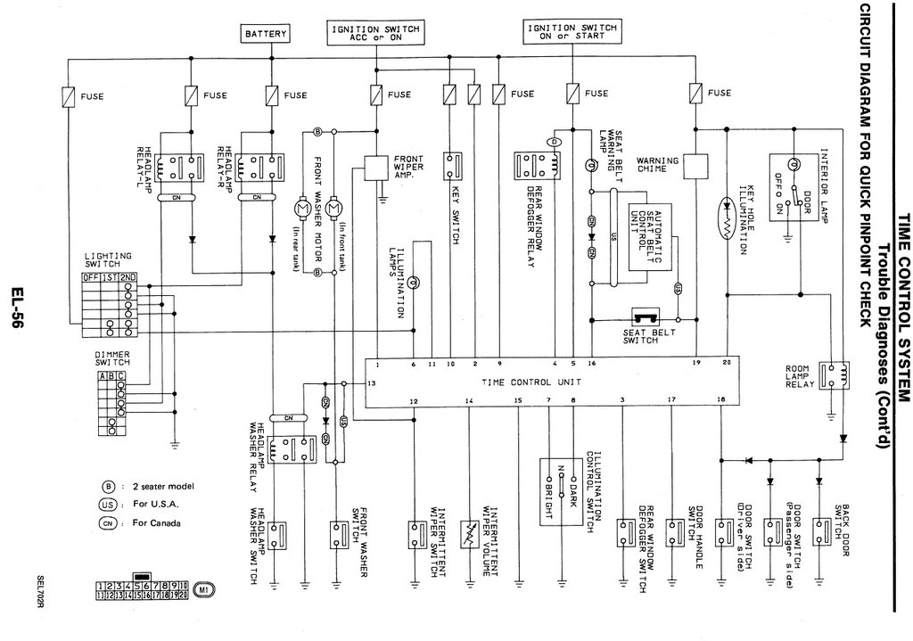

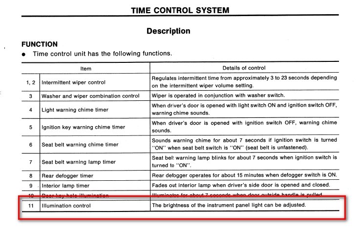

From the FSM, the Time Control Unit (TCU) controls the ON/OFF and dimming of the illumination lights. See 11 below.2020-06-11_132703.jpg.b7da4b4306eca9fccfaf2531e3c2da56.jpg

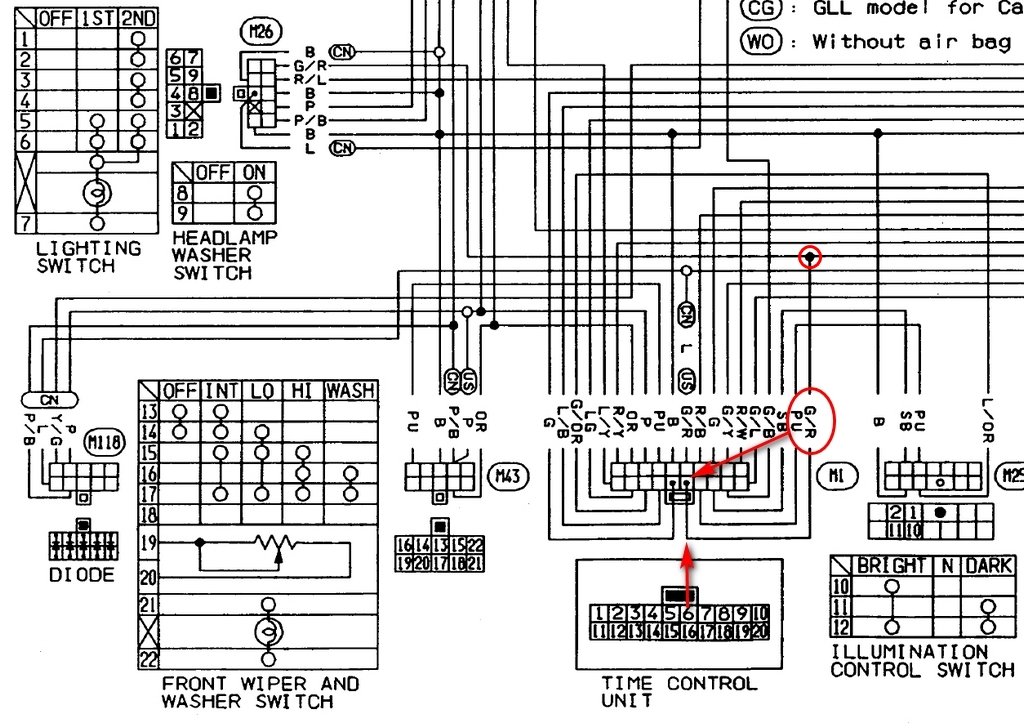

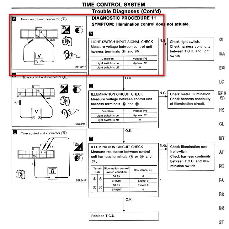

The TCU receives its signal for the exterior lights being switched on (both side and mains) on through pin 6 on the
TCU. 0v when they are off and +12V when switched on. If that signal is cut, then the TCU won't know when the exterior
lights are on and should leave all the instrumention lights on daylight brightness at all times (with the ignition switch on).
The wiring harness shows that the TCU pin 6 wire is G/R (green with red strip). The cut needs to be near the TCU as the
same signal is used elsewhere in the car. Note - there may be side effects with the TCU's other control functions (see table above)
also using this signal. I don't think there are but you will have to see. If the modification doesn't work reconnect the cut wire.

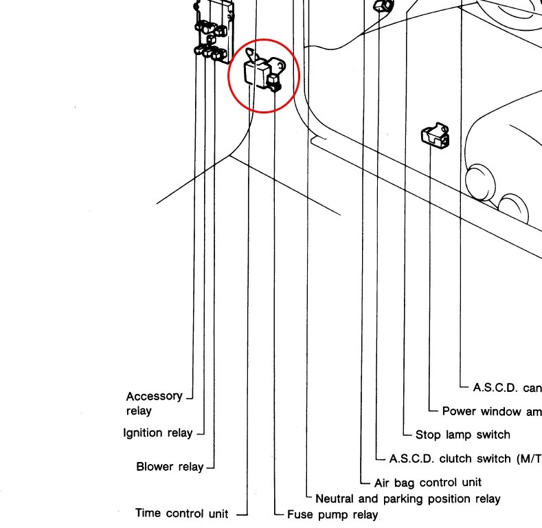

The TCU is located behind the drivers kickspace panel (small white plastic box with a green relay on one side).
