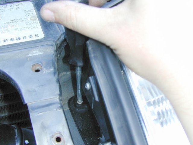

Is this possible without removing the bumper, or is it just easier to remove the front bumper and get access?
You don't need remove the bumper, you've to go inside the arch liner for one bolt or nut, inside the corner lens for another, 2 more inside near the air filter, it's doable.

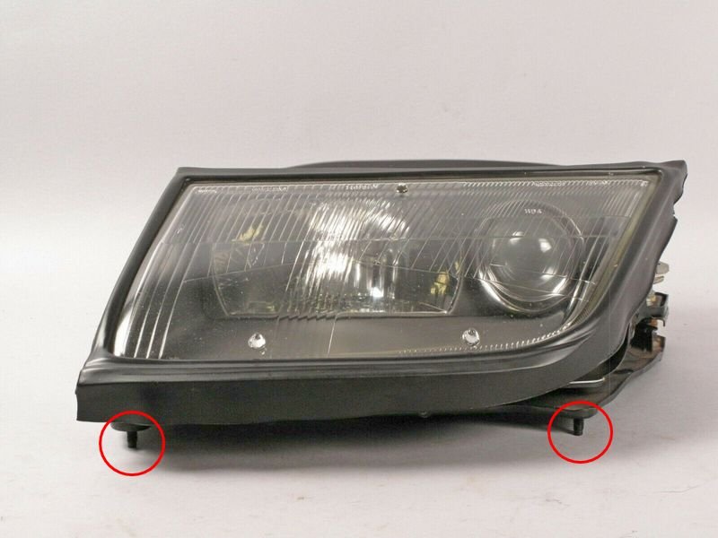

Just a couple of things to add. Take great care when removing (and refitting) the headlights with the bumper in place to avoid scratching
the paint work on the bumper from the two front fixing studs (as shown below). Masking tape layered up on bumper upper edge can save
many tears!

They are a bit nasty those front two studs, you do have to be careful, I put a folded towel there, one of the wife’s best white ones as well ?.
