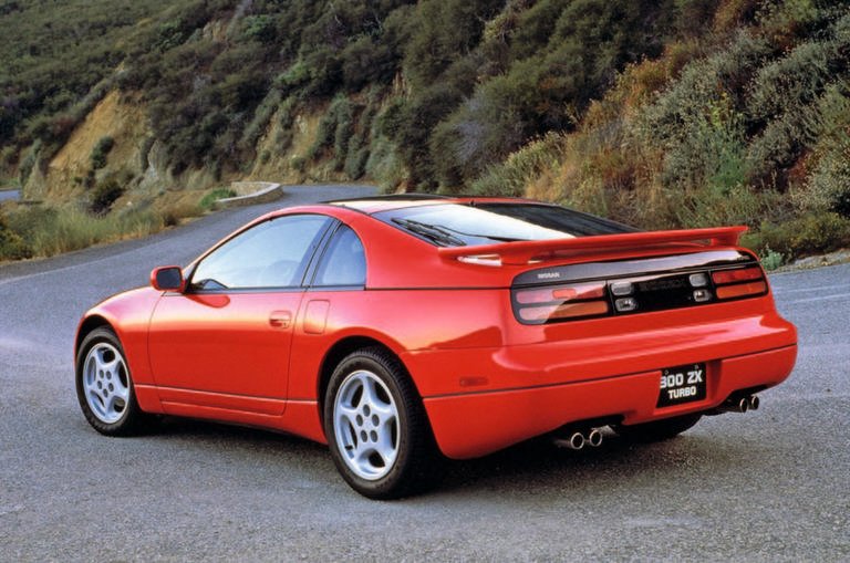

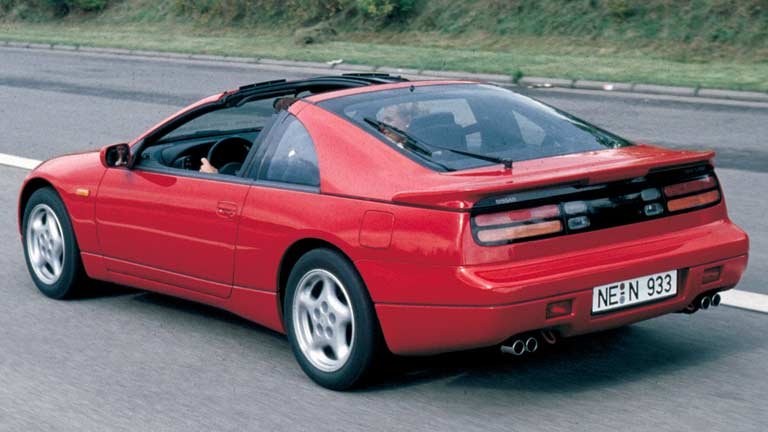

What year is your car? From the factory '89-'93 TT's had the earlier spoiler shown in the first image below, whilst '94 on had the second (so called tea tray) spoiler.
Nissan changed over to the later type because of problems with rotting with the earlier foam based type. Note the third brake light types used for each version, the
earlier one is part of the spoiler itself, the latter one (like yours) is part of the boot lid.
