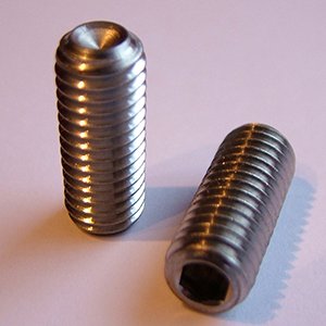

I supposed so to, but cannot help to think there is a specific shape on the tip (see first picture of supposed Nissan plug needed)...

Problem is really, that the small conical shape you have at the end of the thread, is inverted compared to my old BMC ! meaning you can screw the old OEM plug, but after 2 turs you get in collision with this inverted conical shape = no possible fluid tightness
Correct, this seems to be it !
Now I need to find some with the correct diameter and pitch (M10 x 1mm). Let's see !
