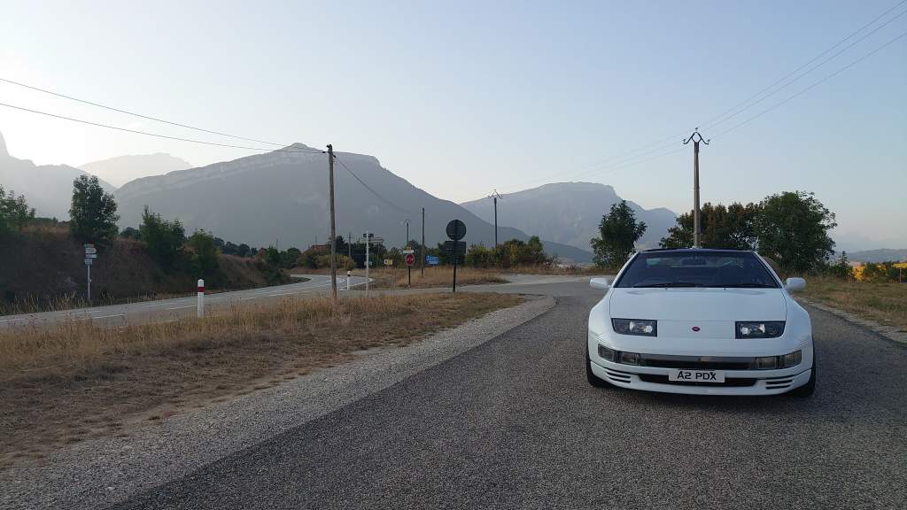

It all rather depends on how many letters/numbers make up your registration. This is my front plate (355mm x 111mm)
with legal character sizing and border.
[ATTACH=CONFIG]119034[/ATTACH]
Your car really does look epic with those headlights, that was a good move! One of the things I’m not keen on with them is that they highlight the projector housing being slightly lower than the reflector which can make it look a bit googly eyed(!), but the headlamp washers on the UK cars seem to mask and correct this to the point where it not noticeable.
