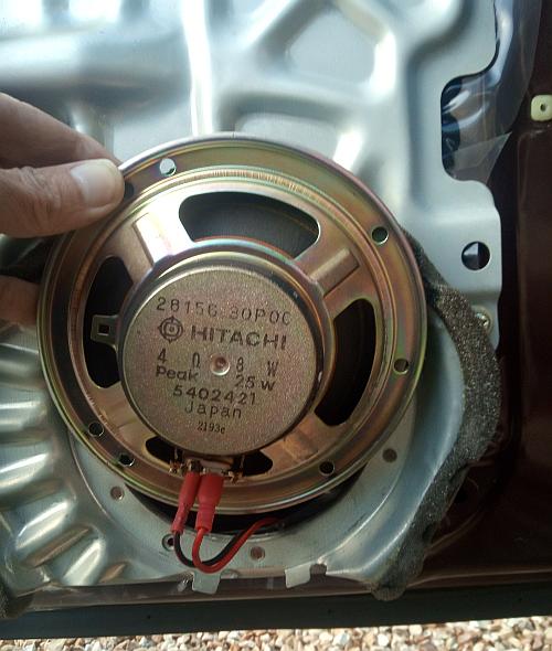

Aha - they're neither 6.5" nor 6" - they're 16cm! Which is pretty much 6.25". Inspired by that how-to video, I bought some pry-bars and set to (sunny day after The Archers).
As you can see the roll surround is toast - thought they were sounding rubbish. So thanks for the suggestions, I'll go read up. From memory, I had a pair of 8" JBLs some decades ago in the Capri :)
From the part numbers on the magnet, I'd guess these were original factory fit.

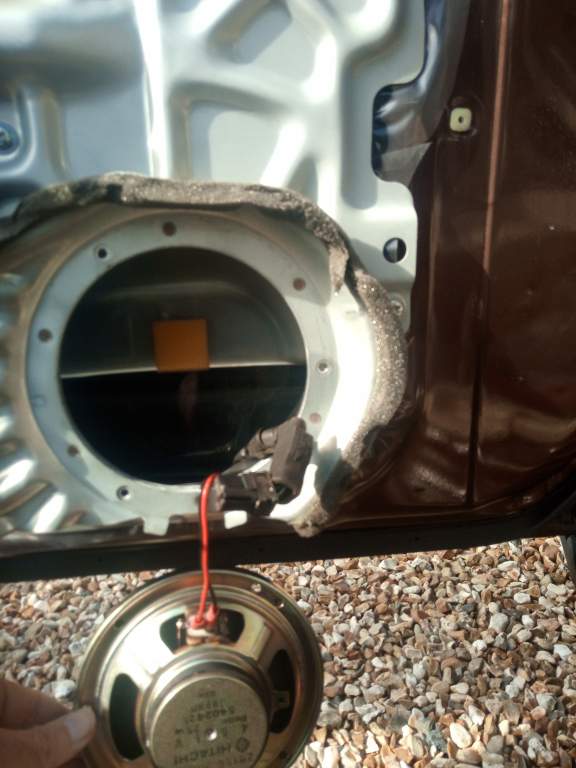

Why do they bodge the wiring? Couldn't be bothered to get the right connectors, lazy b'stards.

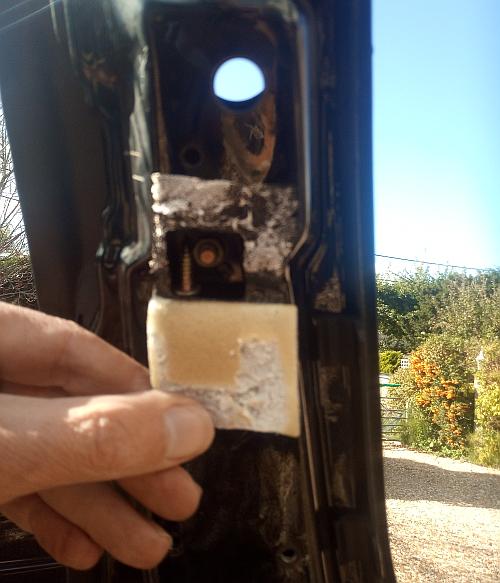

AndrewG suggested to get some foam for the surround - he's right because that foam seal is crumbly and u/s. He suggested https://www.ebay.co.uk/itm/Regin-Single-Sided-Foam-Sealing-Tape-12mm-X-12mm-REGJ60/360392257558?ssPageName=STRK%3AMEBIDX%3AIT&_trksid=p2057872.m2749.l2649 and I ordered some which has now arrived.
I also found adapters https://www.ebay.co.uk/itm/72-9300-Car-Auto-Speaker-Radio-Audio-Harness-Wire-Connector-For-Nissan-Mazda/174039508291?ssPageName=STRK%3AMEBIDX%3AIT&_trksid=p2057872.m2749.l2649 (I suggest a bit more searching as these ones are from Malaysian seller despite it saying they're posted from Hayes and took 9 days to arrive) so I'll be seeing if I can reinstate the OEM harness and remove the bodged extra speaker wires.

You are better off using the OEM metal speaker brackets which will (with new sealing foam) properly fit
the aperture and contours of the inner door panel and the door card to give the best acoustic sealing.
Get them s/h.
The picture first picture shows the old sealing foam in place on the reverse. The second on the front face.
