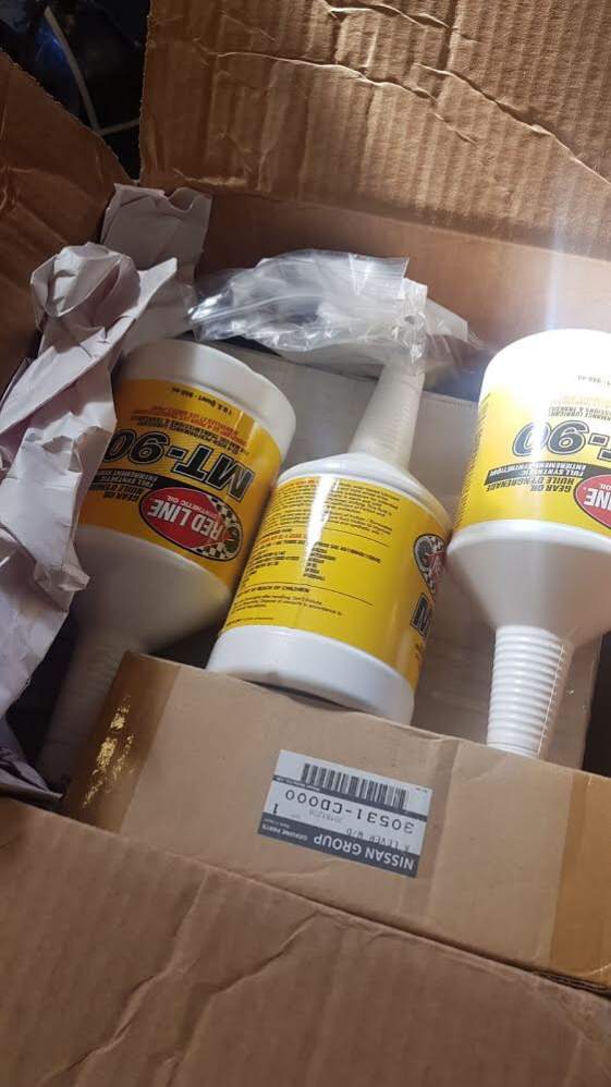

Have you tried Redline MT-90? My gearbox became noticeably smoother after about 1000 mile run in.
Hi Andrew, long time no see bud....... the issue hasn't got any worse over the years but irritating because when I'm putting the car to work it will crunch between 3 to 4 but I'm going to try that redline. I'm going to fluid changes all round.

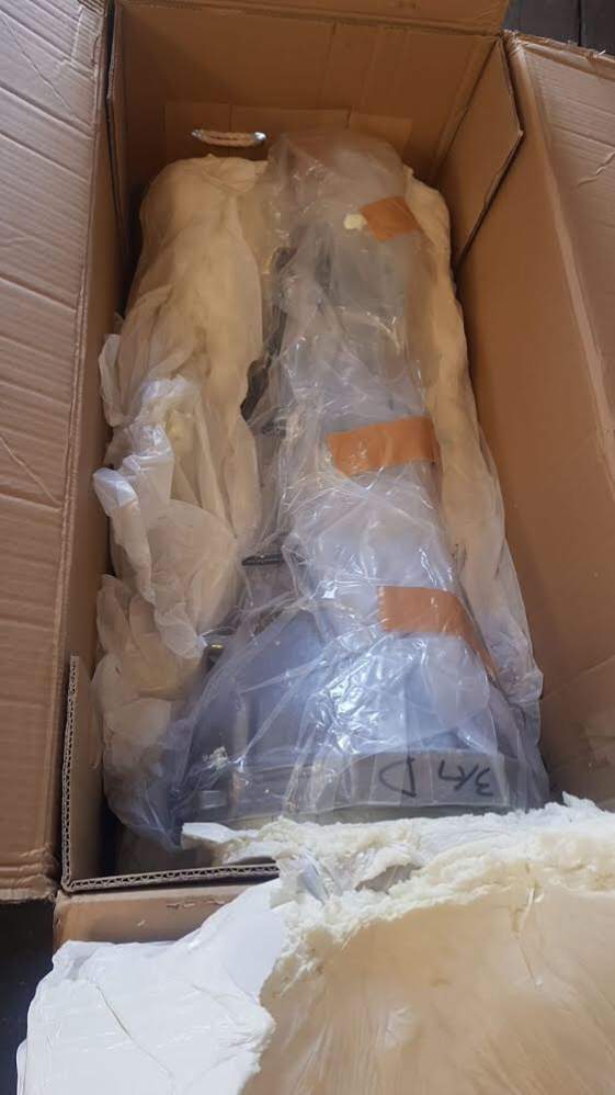

I have just managed to get a second hand gearbox + for a manual conversion at £1000!
This is my second attempt at sourcing a manual conversion, so that is for the lot.
I did see a couple of manual gearboxes for sale a few months ago at around £850 but they are getting rare!
I have also just received a full clutch assembly from Mike too at £340. Thanks Mike great service.
So hopfully get started soon & back on the road.

I got it for Graham from CZP.its a sit down price well over 2k landed but i think that is cheap being honest for a new 5 speed box.
