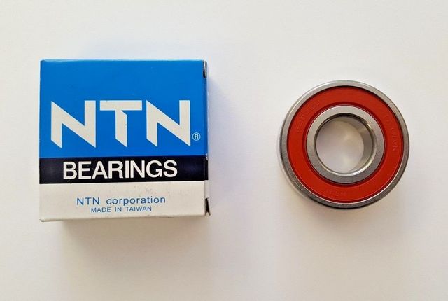

It has been attempted to remove the compressor pulley and extract the bearing in situ, but so far no one has been successful. It’ll be unit out for reconditioning I’m afraid.
