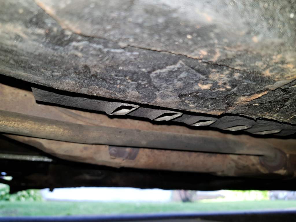

So I've taken the Zed of the road again because it seems the OEM exhaust has aged like milk and now it's crumbling, falling to bits when touched and pretty much leaking all over the place pre-catback.
Luckily I have a Longlife exhaust firm in my town (also have Powerflow but I don't fancy having the exhaust thrown together by some ned with daddy issues) which I'm going to see about a 3" straight through system from the turbo's back but my question is about certain hoses/pipes that seem to feed into the OEM exhaust front pipes at the sides.... what are they? I've searched high and low to find out what they are to the point where Google probably thinks I have an exhaust fetish but no luck!

o2 sensors for a start

No Tony, what he’s describing is the AIV inlets. OP, you can delete the AIVs. These pipes you describe are the small tubes feeding into the downpipes. The whole lot can be removed.

Thanks for the reply Funkysi
About the AIV inlets: does that need any certain kit to delete?

Thanks for the information on what those pipes actually are, been scratching my head about them but now I can research how to delete them.

Had a look through the guide and it turns out the AIV solenoid has been removed previously although when I got behind the inner arches the hardware is still sitting around waiting to be taken out which i'll get round to in due course.
