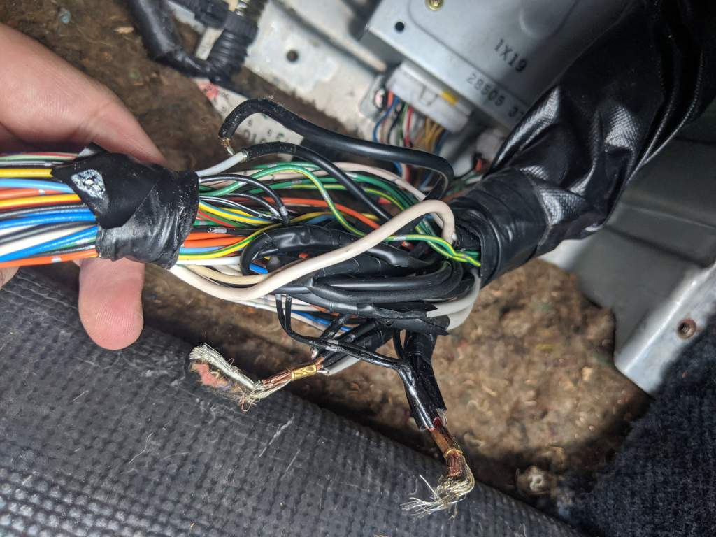

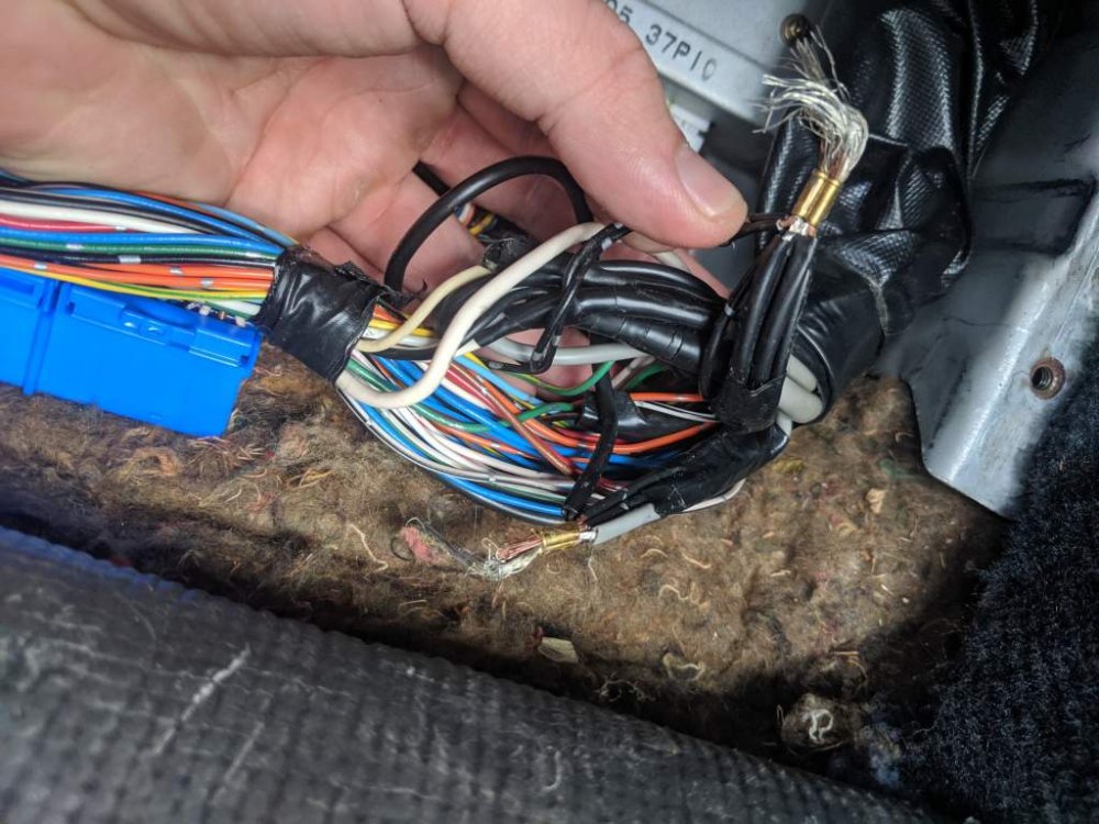

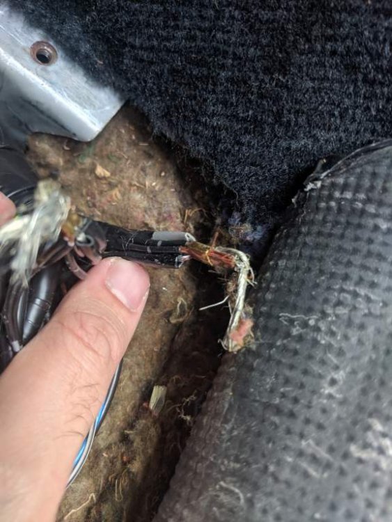

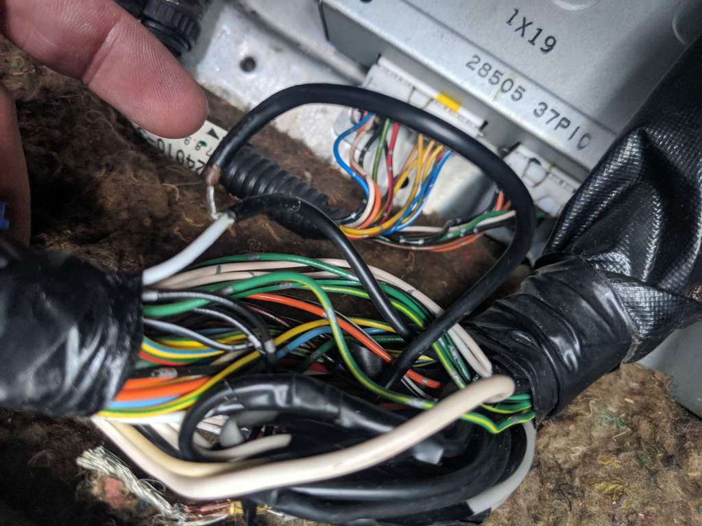

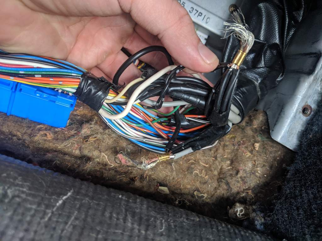

Okay so one thing I have done recently is swapped out the ECU. I noticed when I did this there were a bunch of things wrapped in electrical tape on the harness so I wonder if I have disturbed something that might be causing this.
I have just unwrapped the tape and found the mess in the pictures below. Can anyone advise the best way to tidy this up? I know there was an alarm installed in the car but this is is now not in operation, so perhaps these are from that install? I have no interest or need to feed power to anything outside of the OEM harness, I have no active alarm or audio amp or anything like that.
I was thinking id just remove the non-oem looking cables from those big joins of all the black wires and redo the splice neatly?
Put your ‘other’ Ecu back on and my guess is your issue will go away.

I am having a new loom fitted now anyway, so mods can go ahead and close this.
