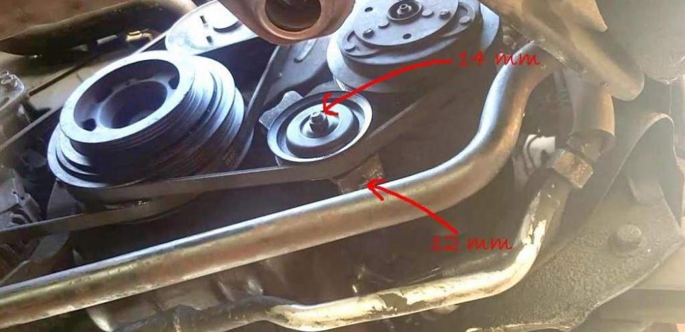

Forgot to mention, it can be reinstalled with basic tools, the right size socket on the outer race, keeping it level and driving it home (if they don’t have access to a press). Once it’s fully home, there is just enough beef left on the outer edge to peen the edge over in a few places to hold it in place (assuming you don’t have the right size swage tool!), that said, I still installed mine with some Loctite bearing adhesive for belt and braces. It will need pressing out though.
Jeff, Ive just took one off bud
