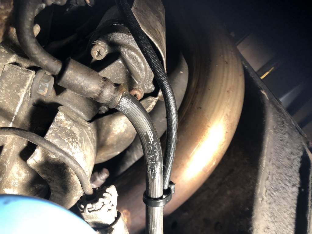

So I got the car up in the air today and made a start on diagnosing the problem. I’d looked at a diagram showing the system and thought that the only two places that could fail had to be the cylinders but my initial look showed no signs of a fluid leak up high near the master cylinder.
After jacking the car up I noticed some fluid around the slave cylinder and flex pipe leading to the slave but not and awful lot. I cleaned up the small amount of mess but there were no obvious leaks. I pressed the clutch in and out and reinvestigated the offending area. Again there was a small amount of fluid gathering on the flex pipe.
Again I cleaned up the area and this time found a split in the hose. BINGO!!!
So it looks like I need a new “hose clutch” (part 17). Has anyone know for this part to fail, do I need to think about replacing any other lines?
A braided line is readily available to replace that,However it may have cost you a master cylinder also.Cylinder bores wear over time and a lip can form inside.The loss of fluid causes the cylinder rubbers to travel past the lip which can flip them rendering it useless.If the fluid rises in the master when its pressed rather than drops its quite ightly its toast i am afraid Chris.Give it a try first and dont be too quick to write off the master when you struggle to bleed the system,And believe me you will it can be a pig !!! I use an Oil can thats soley been used for Brake fluid and back bleed the system from the slave pumping the fluid back through the system with the bleed points open.You will still have to bleed it the conventional way after but it gets the system filled quicker.
Thanks Jim. I have been told about the potential failure of the master cylinder seal but not how to recognise it. :thumbup: And I’ll have a good look around for a braided line.

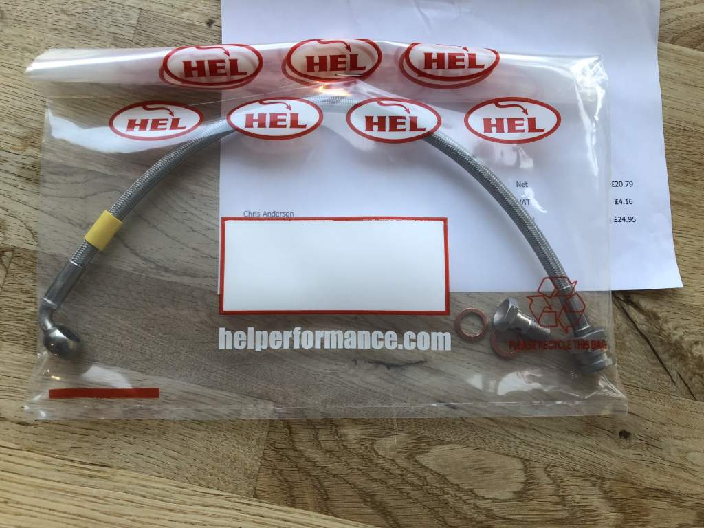

So two sets popped up straight away. If anyone has feedback on either set I’d appreciate knowing it...
MLR
HEL
Edited by Chris300

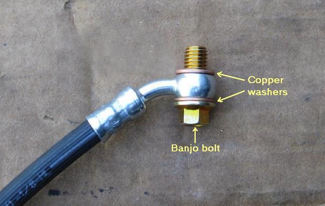

I went for the Hel product, only as I’ve brought Hel products before and have always been happy with the quality the provide.
One question I have, do I need to put any fixing tape or agent on the thread at the coupling?

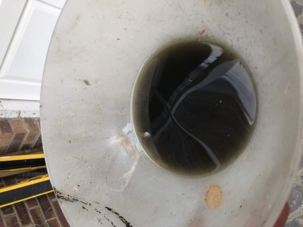

I finally got round to bleeding the clutch today. Unfortunately I had to attempt it by myself which made the job very tricky particularly as the car had been pushed into the garage with little space to work around it. The fluid I got out was very black but is now running nice and clear. However although I’ve now got enough on the clutch to move the car the bite point is very low and I still have around 3inches of slack clutch. I’m hoping that I might be able to get some help tomorrow and finish the job off.

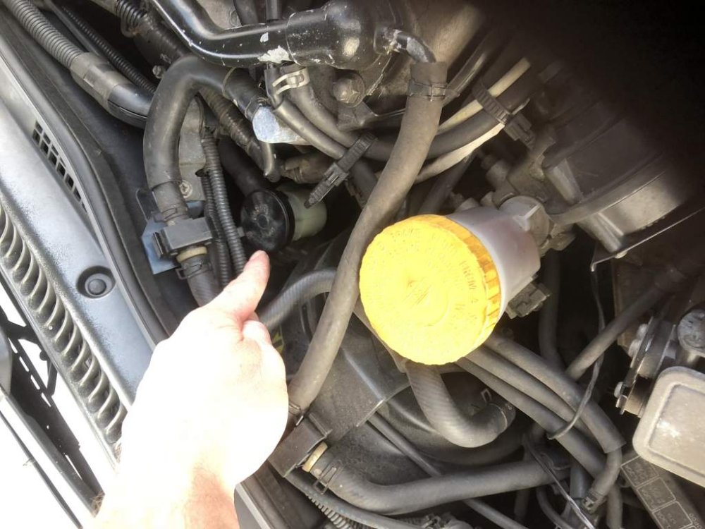

Does it matter which nipple I bleed it from now? Also I was unable to bleed from the reservoir nipple as I couldn’t get a spanner to it. Is it worth cutting a spanner down to get to this nipple?
