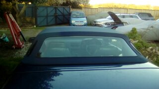

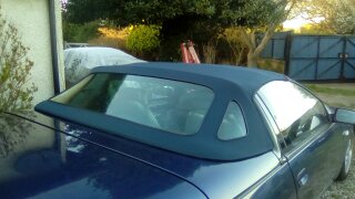

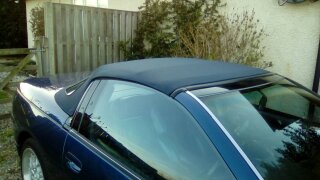

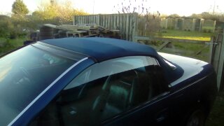

I eventually found a supplier that would manufacture and fit a new hood on the Vert and have had it fitted, however being unfamiliar with the convertible I was unaware that the two "Latch Catchers" one on each A post were badly damaged and as the supplier explained the hood would not fasten to the windscreen surround securely, it was not evident with the old hood as it was so stretched and the stitching was beginning to give way.[ATTACH=CONFIG]116647[/ATTACH][ATTACH=CONFIG]116648[/ATTACH][ATTACH=CONFIG]116649[/ATTACH][ATTACH=CONFIG]116650[/ATTACH]
Above Photo's of the old roof
