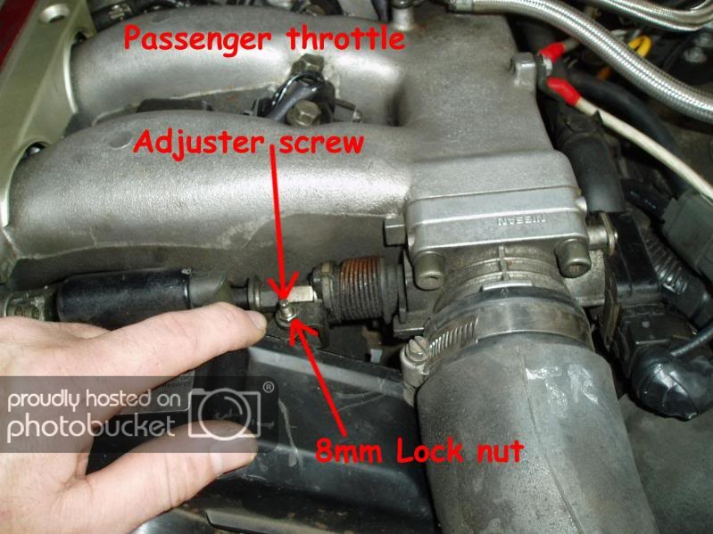

The throttle balance, twin throttles working off a single cable, very common for the synchronisation adjuster screw to be mistaken for the idle control screw ( a little knowledge can be a bad thing ) and that will mean one throttle is leading the other, this is an air imbalance and also is a throttle sensor imbalance as the throttle sensor tells the ignition to advance to prevent stalling and hesitation, now the tps is on one side only, so if the opposite throttle is the lead one, it will feel like your ready to pull away but wait the tps is still closed ! see simple issue ..big problem.
So once the throttle balance is checked the tps setting will need checking also.

1 Throttle balance
2 Throttle position sensor
