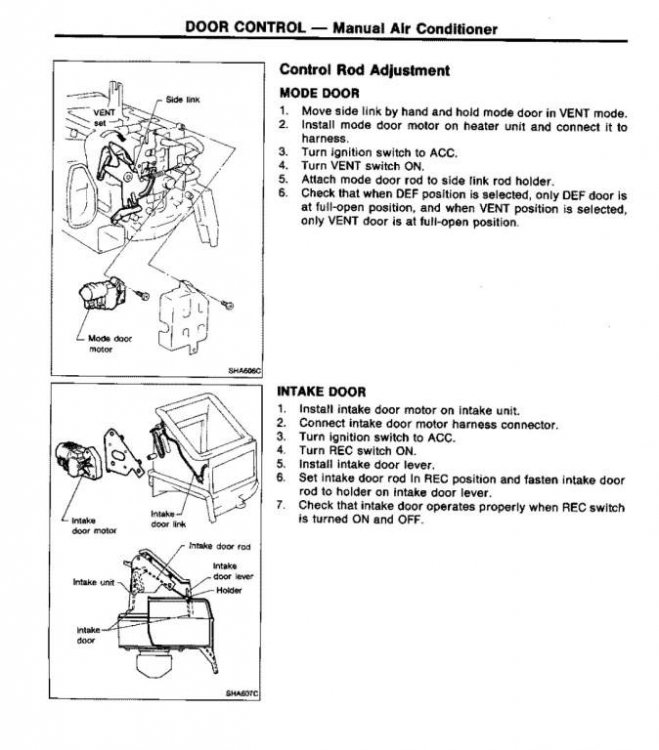

FSM gives me the following:
It states manual air conditioner but there are solenoids present so I'm slightly confused. Has anyone else dealt with this issue before? Did you need to do a dash pull? What was broken or had the rod become detached from the actuator?
Even though the term “manual” is used for the non digital climate control cars, the system for changing air direction etc is still entirely electronic, so the solenoids are still used.
