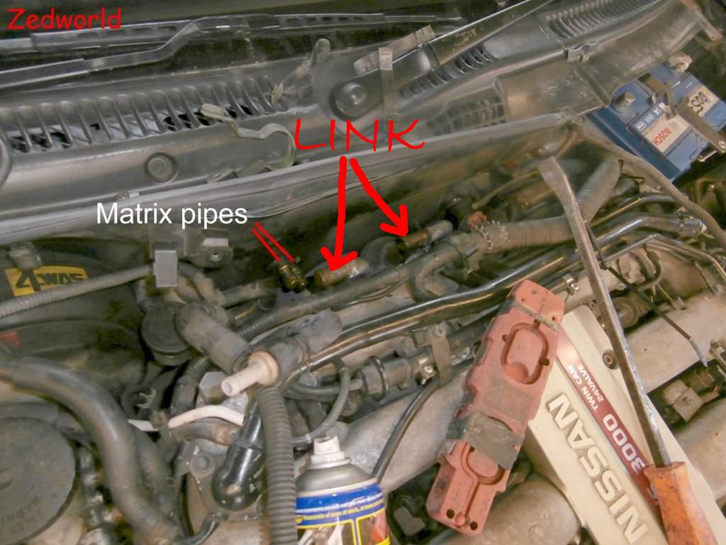

Ok first of all you can by pass the heater matrix in the short term under the bonnet with a length of heater tube from a motor factors, buy two new jubilee clips and link out the two tubes pictures below, the tube can be long enough to circle around and does not matter if it is kinked no need to keep the tube straight.
So, and as far as the matrix, DO NOT USE A SECOND HAND ONE ! loud enough eh? Jim is in Bristol and can be done same day, talk to Jim, for pricing and he will supply what you need also.
The carpets will take some time to dry out in the weather, so best to something to pull the moisture out.
