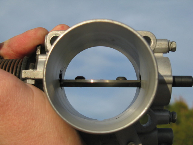

Well after a few weekend of make the parts I need to machine the throttle bodies, both are bored out to 56mm and now machining the throttle plate to mach each bore. Before boring the throttle bodies I checked the roundness and you could pass it as an egg shape....! So when cleaning your throttle bodies do not remove the black paint on the throttle plate or bore, I have all so made some new spring spacers. The Z1 58mm throttle body came from a 200sx with the part from 300zx excepted the throttle plate.
Yes, OEM z32 throttle body to 56mm and moved the bearing out by 3mm each side.
Here you go
a373617ce78f522bc36b34df0d3d09a8.jpgc9b25dd39a1daeba023f371c145efe6e.jpg77c048377c1f0c63521f937cd79d17ba.jpg
I have put the OEM throttle plate on top of the 56mm to show size
Last two with out new 56mm throttle plate .....!
Well after refitting the springs on both sides ( thank goodness I found the Z1 motorsports instructions as for fitting the springs) I'm pleased how they have turned out. I replaced the 26x8mm bearing with 19x5mm, both have 10mm borea0e8e8c57da20d7ad8e1f607399f1ce6.jpg
I can say that looking into the Z1 throttle bodies are new casting which are then machined with bearing seats moved out.
