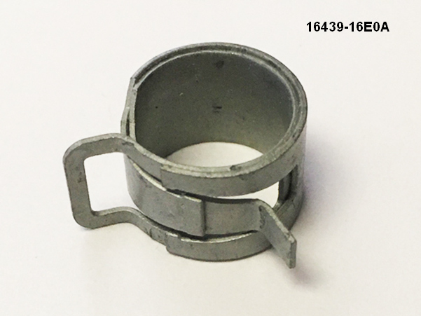

If you’re going to go down the spring clamp route then you’ll mainly need the 12mm ones but get some either side of this size to be sure of snugness.
You can buy in bags of 10 from the Far East for not much money if you’re prepared to wait.

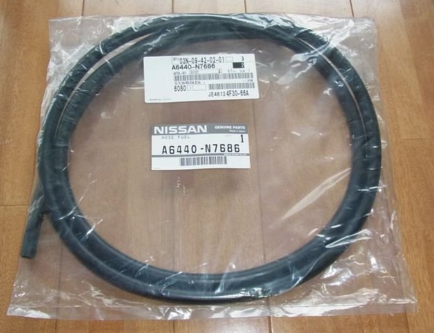

Or just get the right clamps from Nissan, fit and forget!
You could and pay 10x the price I suppose.

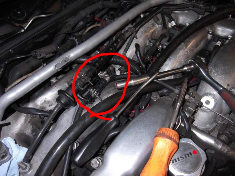

The pipe circled is a non fuel injection type, designed for use with low volume fuel pump and carburetters common mistake when buying fuel pipe from motor factors.

Most of the pipes looked like original Nissan stuff so after 20+ years they were ready for changing.
As Jeff said it looks like that short pipe had non injection hose fitted at some time before I had it. Its all been fine for the last 6 years I have been using the car
but now its all new and the correct grade.:yes:
I have just reused the older style clips .
Im sure they will be fine.
