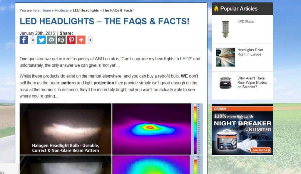

Aftermarket LEDs have a long way to go before catching up with modern production LED headlight technology. I wouldn't bother.
Stick with a low K HID kit or a standard halogen bulb.

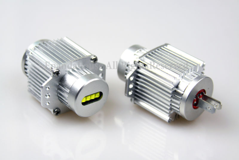

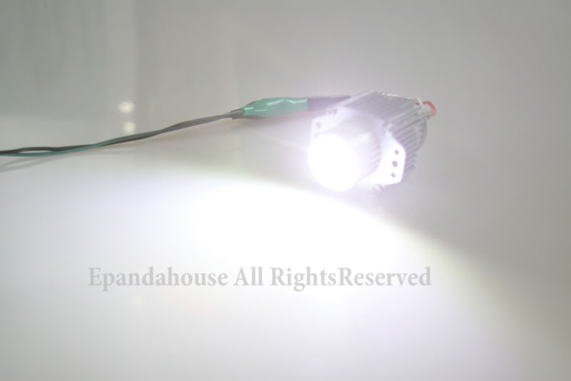

After I was doing this I read about these oldish BMW LED. Looks like they would shoot all the light forward,if modded into the main beam no 300zx reflector would be used, but that would not fit in the bulb socket on low beam.
LED light apprars to be more directional so we should find one that shoots light forward and through the low beam lens, not reflect sideways via the old dull reflectors. 3-JPG.jpg
