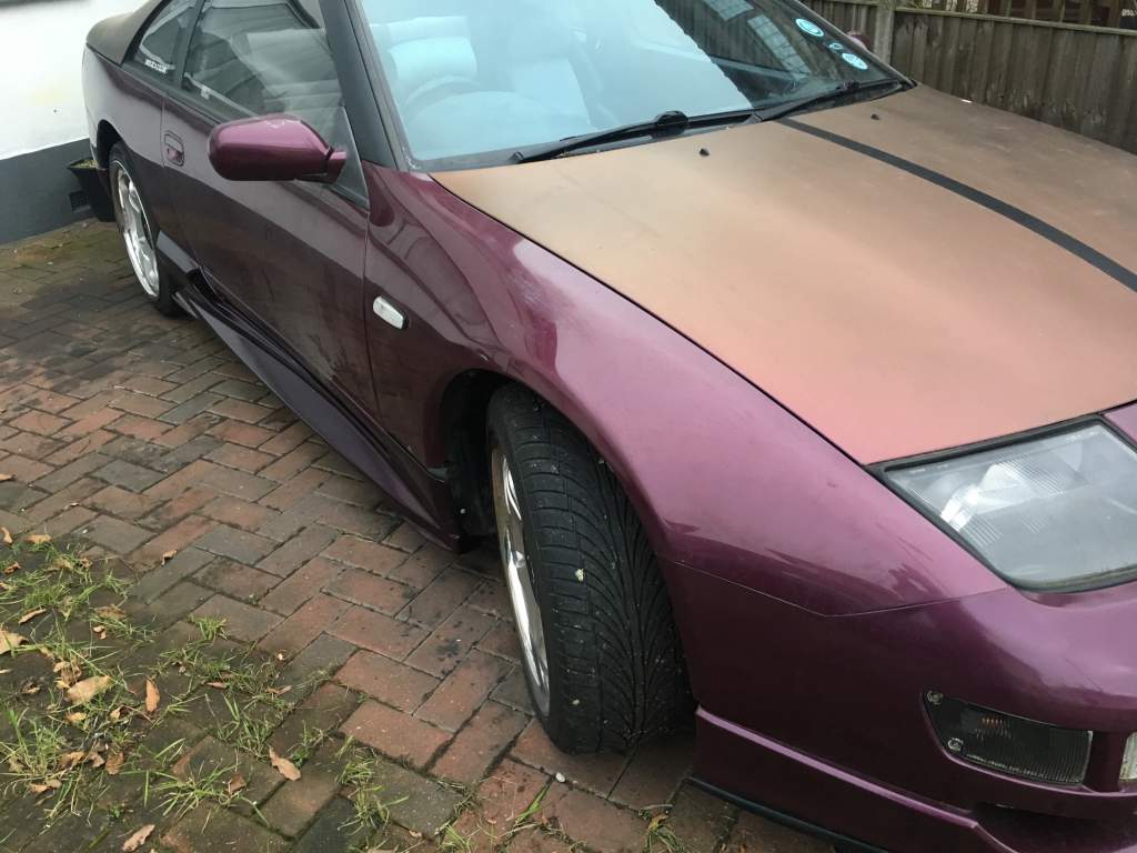

I smashed off the remaining veilside side skirt!!!!
[ATTACH=CONFIG]116044[/ATTACH]
And it is going in the bin at work tomorrow...........
Getting her ready for a fresh respray and possible colour change...........:whistling:

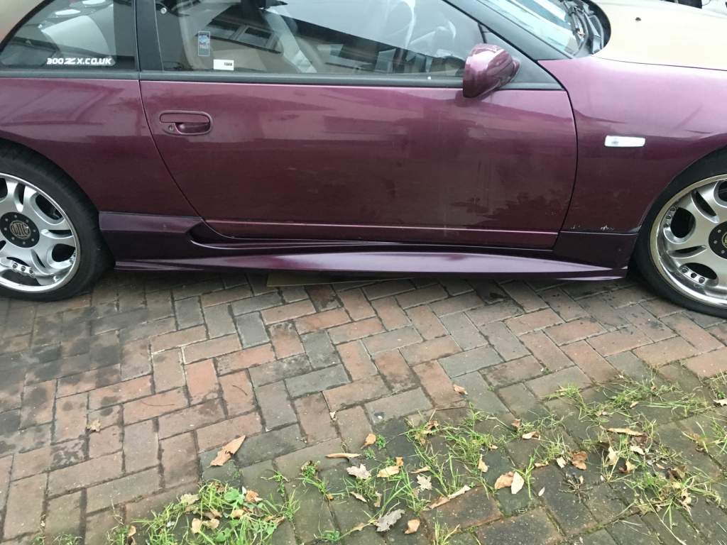

Test fitting of their replacements....
[ATTACH=CONFIG]116045[/ATTACH]

Well yesterday I gave the sills a coat of Frost's Stone chip and sound deadening coating that will be behind the side skirts and not seen to protect them from anything thrown up behind the skirts.
The side skirts will not be bonded to the car this time...... and will be bolted in place using bike fairing fixings with stainless steel dome head bolts.....
These....https://www.speedyfasteners.com/ProductDetails.asp?ProductCode=SF133
The thinking is they are rubber inserts / fixings with the captive nut and will stop any water ingress through the bolt holes into the sill or water getting under the skirting and sitting where they are mounted causing rust....

Today was finishing off fitting the side skirts ready for paint soon.....
They are now fitted and ready for the bodyshop to prep and finish what I have started.....
Here's the proof I actually did something on a Sunday..... :sweatdrop:
