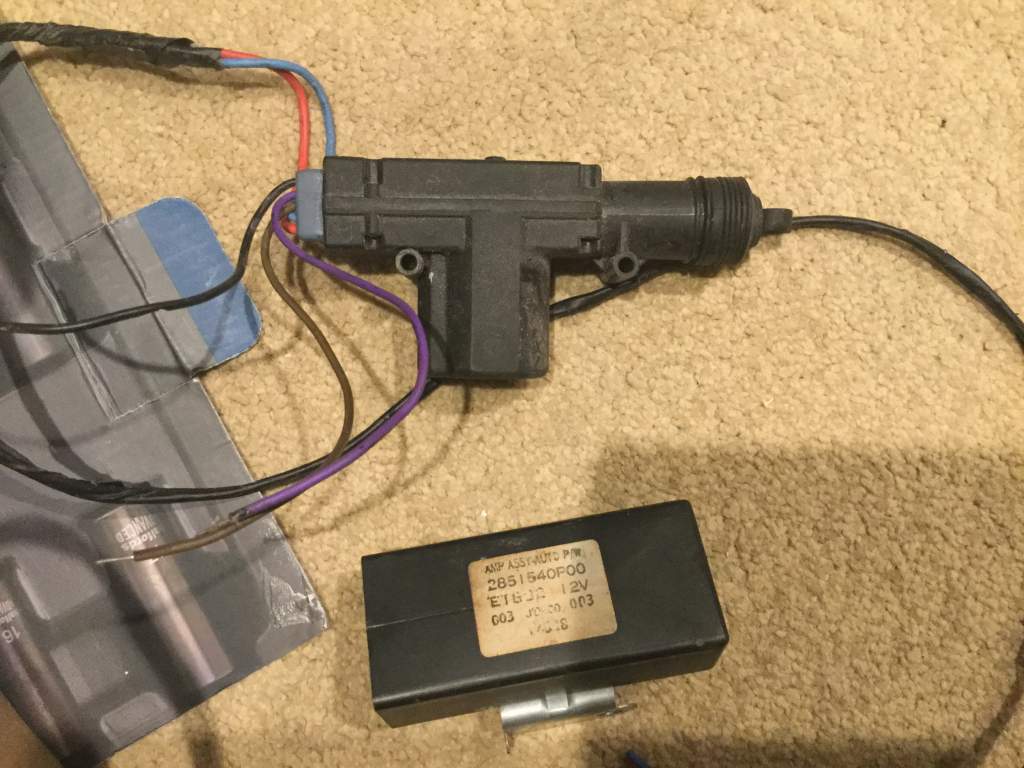

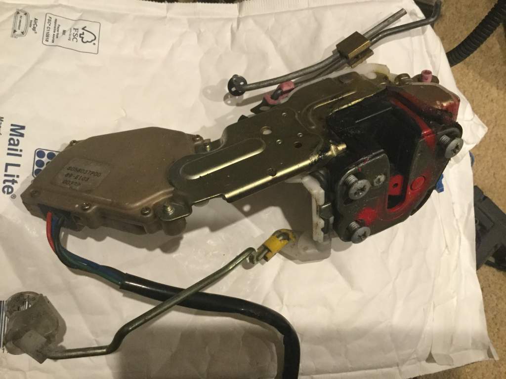

[ATTACH=CONFIG]115165[/ATTACH][ATTACH=CONFIG]115166[/ATTACH]
Sorry mate, just read this now....
Iv actually changed both of these already to find the fault.....
The passenger side does not actually lock either via the key or the central locking now. Any ideas?
What about from in side the car, if not possibly a linkage problem.
