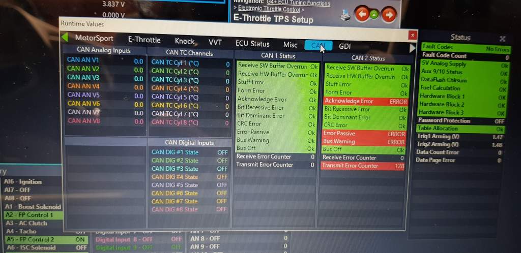

So the grey plug goes directly to the Link ECU via a CANPCB and CANF? If that's the case then section 4.1 of the Instruction
manual for the Can-Lamda device could be the issue:
"Each end of the bus must be terminated with a 120R resistor (1/4 Watt minimum). There is no CAN terminating resistor
in the Link CAN-Lambda Module."
http://linkecu.com/documentation/canlambda.pdf?vid=EdB4IKtpAnKY5mK7&chrole=17&ck=yKBhLatpAm6Y5oaE&cktime=158123&promocode=&promocodeaction=overwrite&sj=T8TxxFuuSCX7UrWdPCMPf91W1%3B1540750743729&gc=clear (See example diagram)
