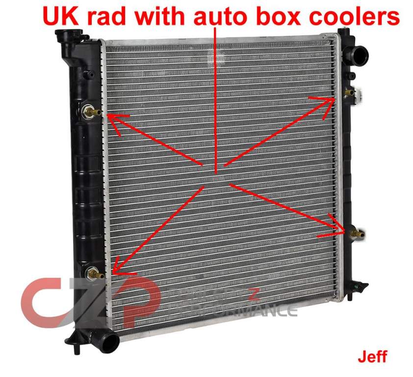

No, the UK auto rad has cooler for the gearbox in both side headers and the import auto rad only one side, the UK does have an additional cooler in the nose area but that is for the power steering, the oil cooler for the engine on UK cars is bigger than imports.
Of course you can fit a manual radiator but will need to fit a separate new auto box cooler which actually is not a bad thing.
Jeff

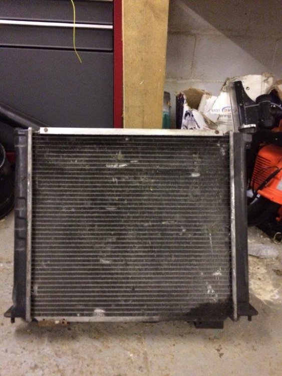

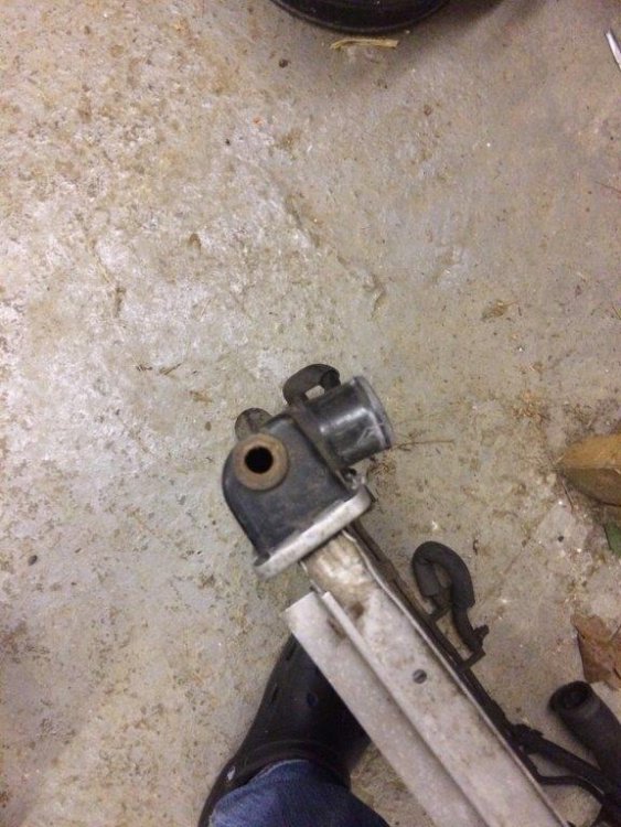

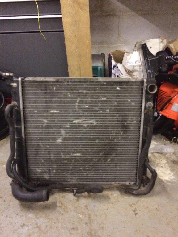

I've got this from the car I'm breaking
UK 1990 Twin turbo auto
Hopefully Jeff can advise if its the right one as very little was left standard on the car

Yep thats the one for a UK with Auto box.... nice one buddy.
Jeff
