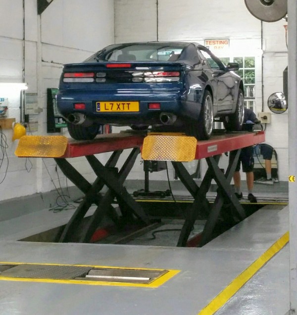

Took the car today to a MOT test place that I hadn't used before and passed with flying colours. Before I went I
swapped out the HID bulbs for the standard Halogen bulbs just in case.
