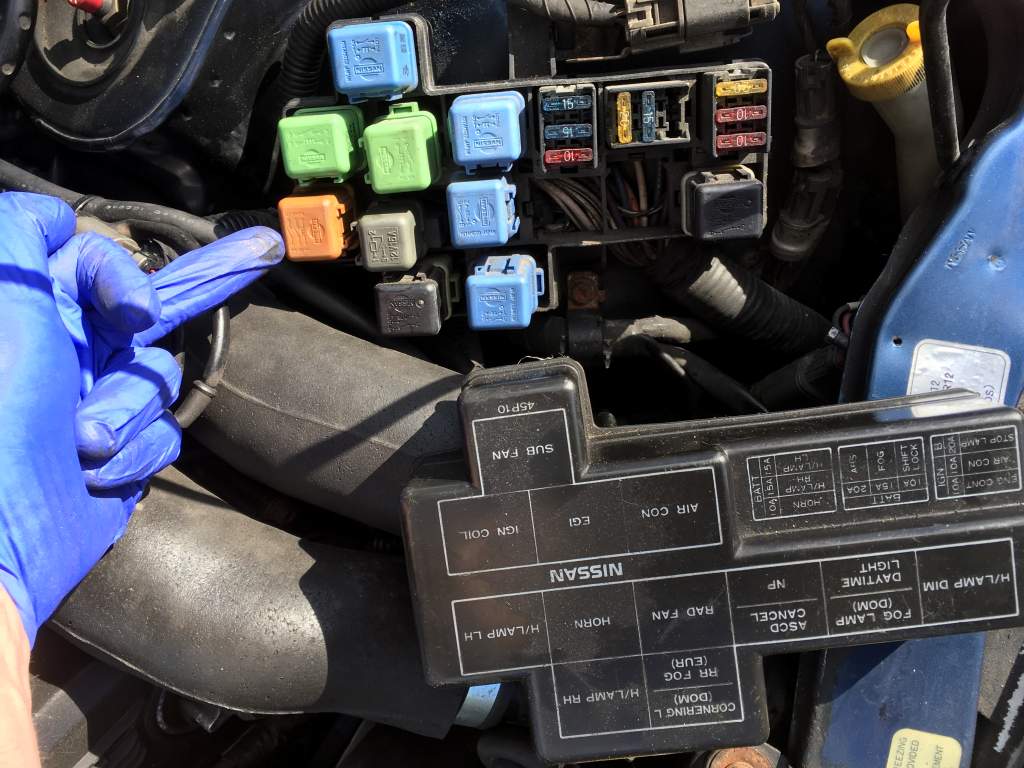

I’m booked in for an mot and whist doing my pre test inspection I noticed the near side main beam isn’t working. I’ve changed the lamp and checked the fuse but it’s still not working. I’m looking at the relays but the near side relay seems different to the offside so I’m reluctant to swamp them over to check it’s working. I’ve attached a picture of the fuse box for you guys to check everything looks as it should. Any ideas?

After testing everything with a multimeter, changing relays and fuses the problem was still there. In the end it turned out the problem was between the lamp holder and the cable. (When I removed the lamp holder I didn’t realise you could spilt it from the cable, daft I know. This is why it took nearly 45 minutes to change the lamp first time. :bored: ) Anyway after separating the cable from the lamp hold I found that it hadn’t been fitted correctly and one of the pins had bent and not gone into the connector. Bent it straight, fitted it properly and then there was light. What a ridiculous problem.:death:
