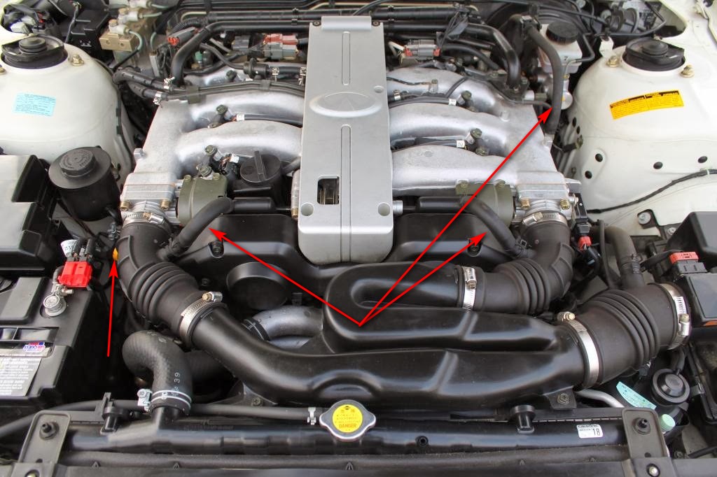

That VG30DE engine is out of Infinity J30. Note the orientation of the hoses and dipstick positions (arrowed)
which are different to that when the engine is used in a NA Z32.

Interesting. Good spot.
Could parts be moved over from his old engine do you know?
