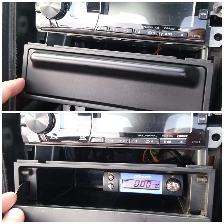

Clock harness colour codes - wiring in an EBC.
If I want to take power from the clock to run a feed to my EBC, which are the best wires to take that feed from?
Assuming the black being the ground, but there are two lives, a switched live from the ignition and a permanent live from the battery. I'm guessing I'll need the switched live? Would the Greddy Profec B lose its settings however if the switched live was used?
I believe green/red (P) and blue/white (n) are the correct ones.
Wired them on red to blue and back to green/brown. It's all working.
Edited by Funkysi
Nice, clean and effective. Although I thought you’d have a drop down cup holder in that space. :clown:
There is no way in hell I'm fitting a cup holder to my Z. :lol:
Yes it is. I've run the feeds to the cig lighter now anyway. Thanks though.
Ah man. I could have answered this one lol. I used the clock wires recently to wire my gauges

I basically only used the blue and white accessory wire. Black for ground.
On a serious note though in case anyone is looking in future:
Blue/while - Accessory 12V
BLACK - Ground
Green/Red - Illumination
Yellow/black - 12v constant

There is only blue with white tracer on the harness for the clock, there is no solid blue.
I said blue and white. So blue with white line.
The order I've put above is in the order of your photo (left to right)
