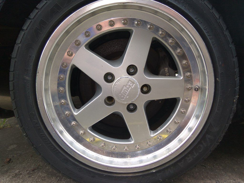

The studs are a press fit with the splines forming a tight fit with the stud bore. Does the one
in your picture not fit back tightly again?
No mate see,i changed the rear bearing and the bear got slightly loose and broke it off(that pic is not my hub mate)cheers
