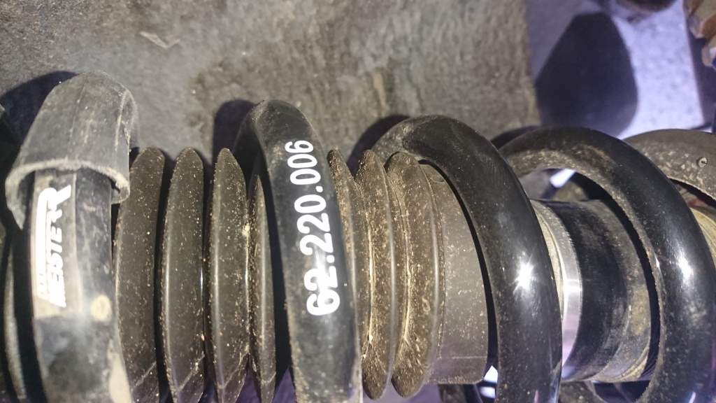

The preload amount is marked on the spring though not sure if you will still see it if they are old.

How do they mark it?

It’s printed on the spring within the text. The number will be longer but part of it will be something like 220. I can’t remember exactly but 220 rings a bell. The preload is simply a measurement in mm from the top of the spring to the spring platform. So basically how compressed the spring is.
In a normal setup these would be the same each side but if you were ever to get the car corner weighted, they would set each corner preload individually depending on the weight at that corner to balance the response of all 4.

You were right Joel. 220mm. The passenger side rear was 10mm different so hopefully now I've changed it it will be a better ride. Don't know why it was different, so called Zed specialist & his apes most probably.
