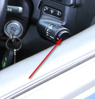

The button on the light switch knob, is that for the front day time running(DTRL)/corner lights by the indicators?
If you mean this button, then it is for the headlight washer:

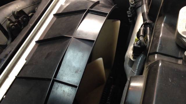

There are two fans.
The one the relay is connected to:
And the custom fan, with a 12V supply from the ignition:

There are two fans.

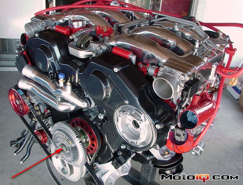

What does the original fan run off? Mechanically driven by the engine? There's an unorthodox racing crank pulley on it, unsure if this means I can't use the original set up?
The viscous coupling which drives the fan is mounted on the front of the water pump (arrowed). You can keep the
Unorthodox pulleys.
